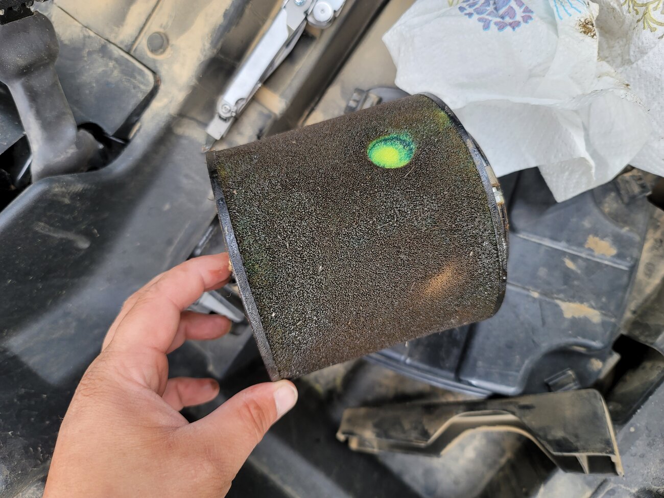

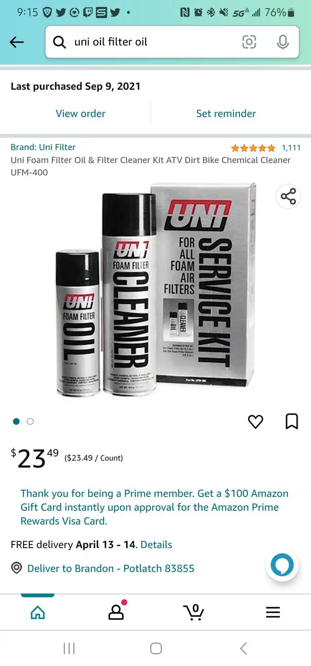

I bought a pack of 6 filters that I would use to change every time they got dirty enough that I thought they needed changing. I used a UNI filter cleaning kit. I don't have pics of when it happened. It happed last fall during hunting season and it has been parked until then. Just now getting the time and money to dig into it. It may be possible that there is a hole in the airbox somehow that is letting dust get in but from what I hear this is a huge issue with these machines anyway because of the horrible location of the stock air intake. I know lots of people who have added snorkels with pre filters to help with this.

Interesting green spot - looks unoiled ?
I’m frugal as s***, I wash those kinda filters with dawn in a bucket and air dry - whatever motor oil is laying around and a ziploc for oiling…
