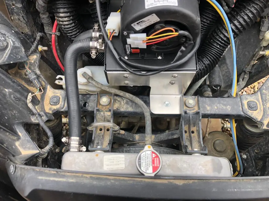

Finished it up. Instead of using the 90 degree pex connector and 2 lenghts of hose as in the instructions, I found a heater hose with a 90 degree bend at the local auto parts store. Eliminates 2 potential leaking connections and is neater.
Driving up and down our road to eliminate any air in the coolant system…. It pumps out heat!
Do you have a part number or size or anything for that 90 degree hose? I'm looking to install this heater soon as I've had it in the garage since last winter and love the idea of an easy less potential leaky solution.

Napa, Amazon, summit, all that is ex to get - jeez, double hose clamps!!!!
