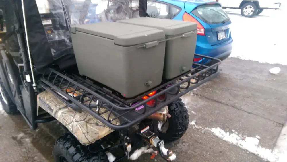

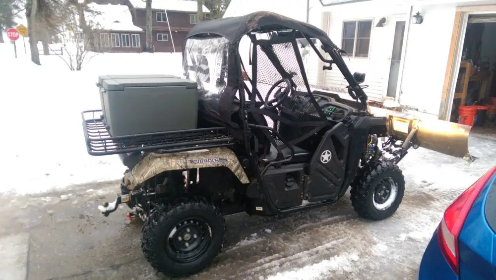

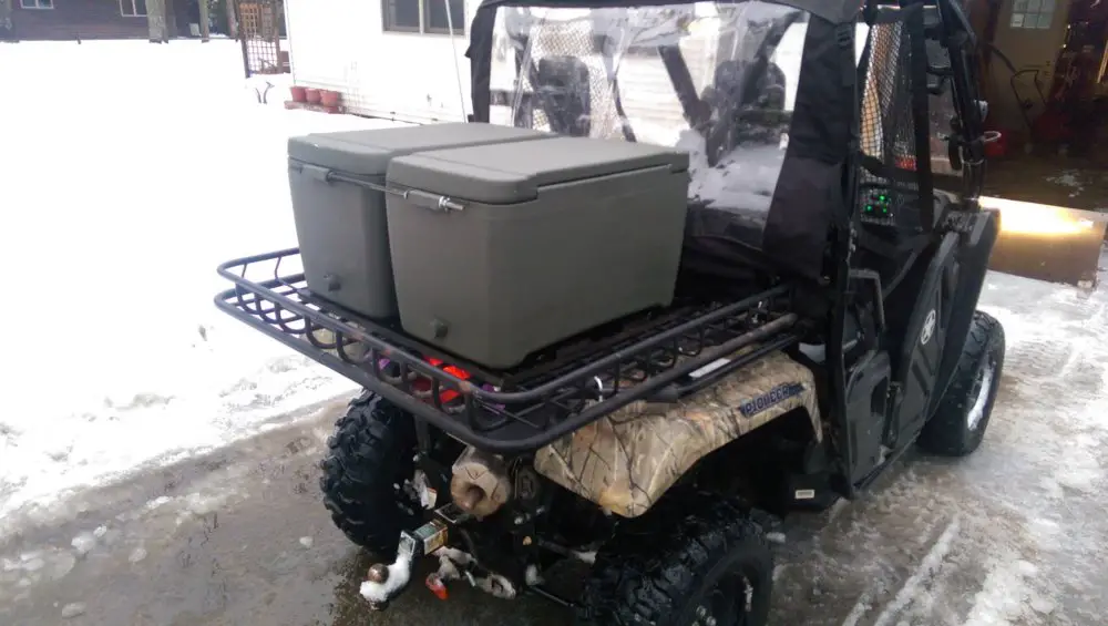

Coolers are painted and done. Helmets and stuff fit in one cooler with room to spare and the other one is leftover for cooling.
I am going to have to repaint them in the Spring. The plastic paint isn't very durable and I'm going to re-do it with Plasti-dip.

I would have mounted them so that the hinges were in the center so they could be accessed from the side of the atv like truck tool boxes. Do you carry a spare?
I considered that, then went the other way. It was a 51% to 49% decision. I don't carry a spare. I carry a tire repair kit, a compressor and a bottle of slime.
