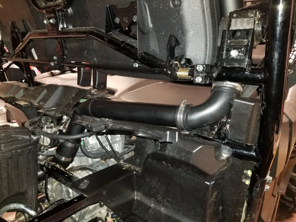

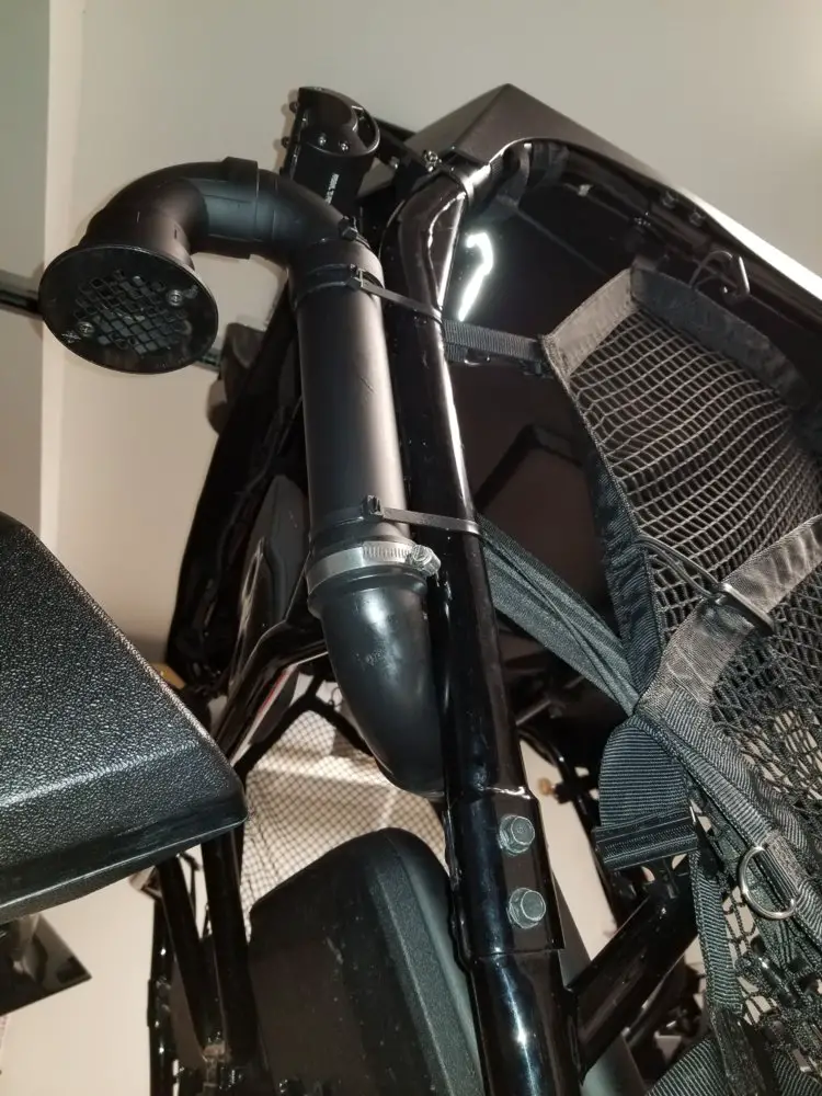

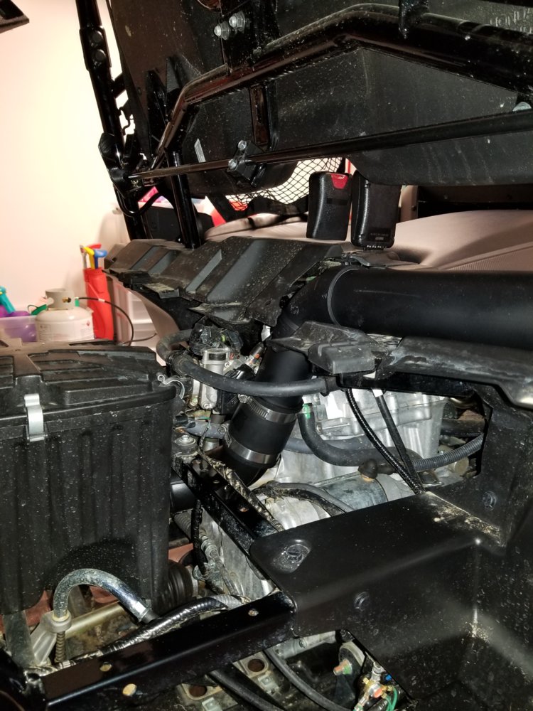

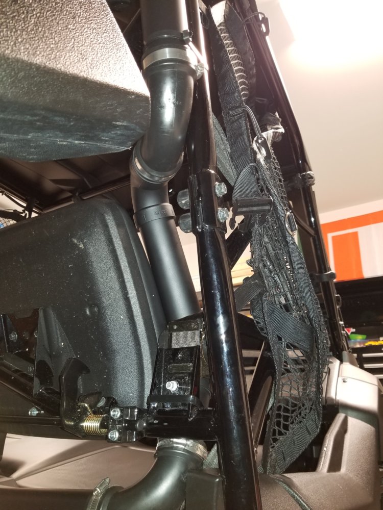

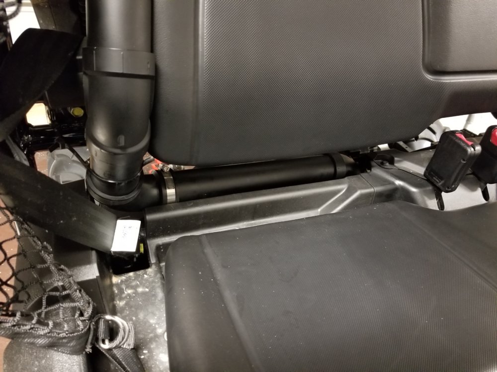

I removed the factory airbox and cut it off just before the initial bend. From there, I started my 2" piping, starting with the straight flex coupling
So, this mod wasn't that bad. All in all, it cost me about $35 bucks. Let me know your thoughts...thanks!
--2" PVC (~6')
--(1) straight 2" flex coupling
--(3) 90 degree 2" flex coupling
--(1) 45 degree 2" PVC elbow
--(1) 60 degree 2" PVC elbow
--(3) 90 degree 2" PVC elbows

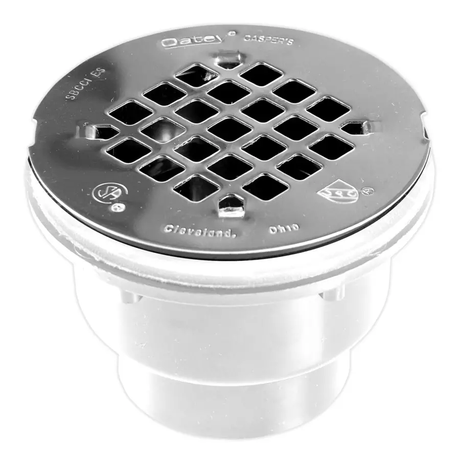

--4.25" shower drain (I went with this, due to the removable stainless steel grate)

Don't know it I like the drain, but I like the rest of it. Looks pretty clean.

Yeah, i'm like 50/50 on the "drain end" right now. My biggest concern (and reason for doing it) was to prevent large debris from being sucked into the intake system (though, given all the bends in the intake, that's probably unlikely to happen). So, i'm going to keep it on for a little while and see if it really grows on me. If not, it will take 2 seconds to remove. Thanks for the feedback!
