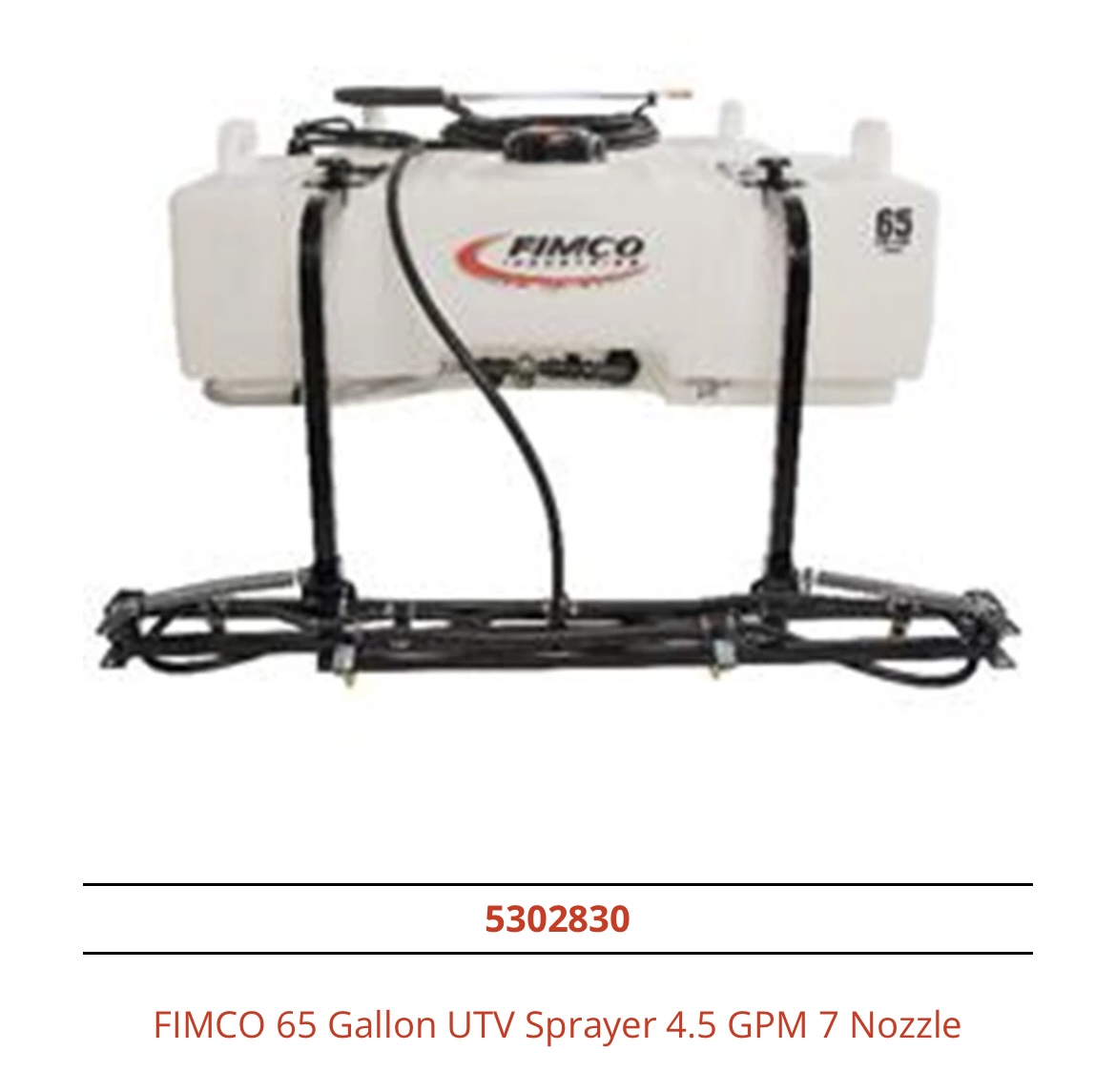

I have one that works off 12v battery and is designed like the one in the picture below. The one in the picture is from Northern Tool. The boom folds in so you can go on trails with it and they have a hand wand for fence lines. I've had this type of designed spreader for 30 years, works great. Just add a plug and switch for the 12v motor and your in business. Note: I don't fill mine to 50 gallons, about half because I'm not on flat ground sometimes. You'll be top heavy when you get the water in it.
