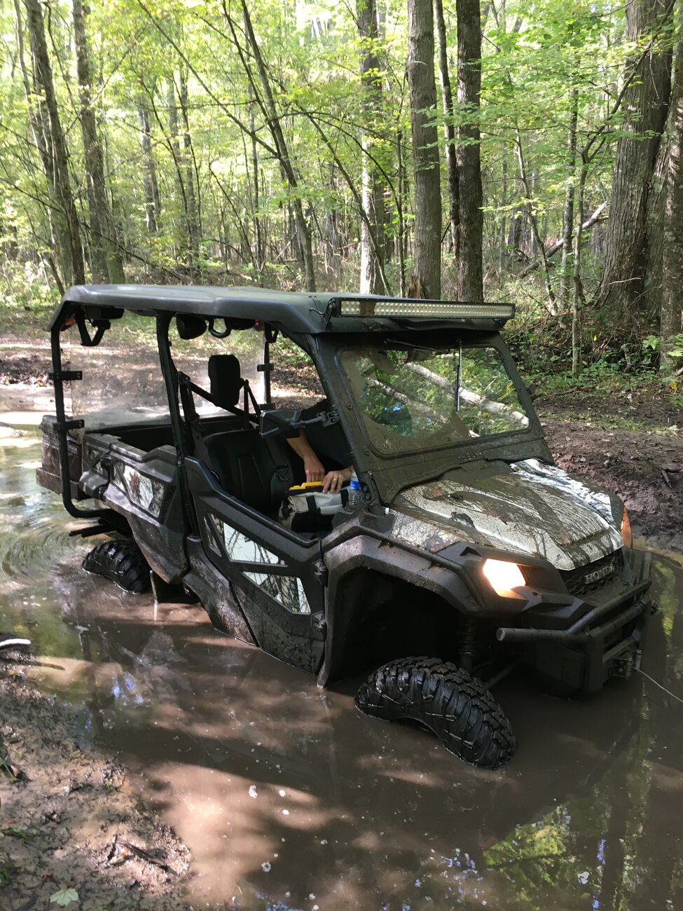

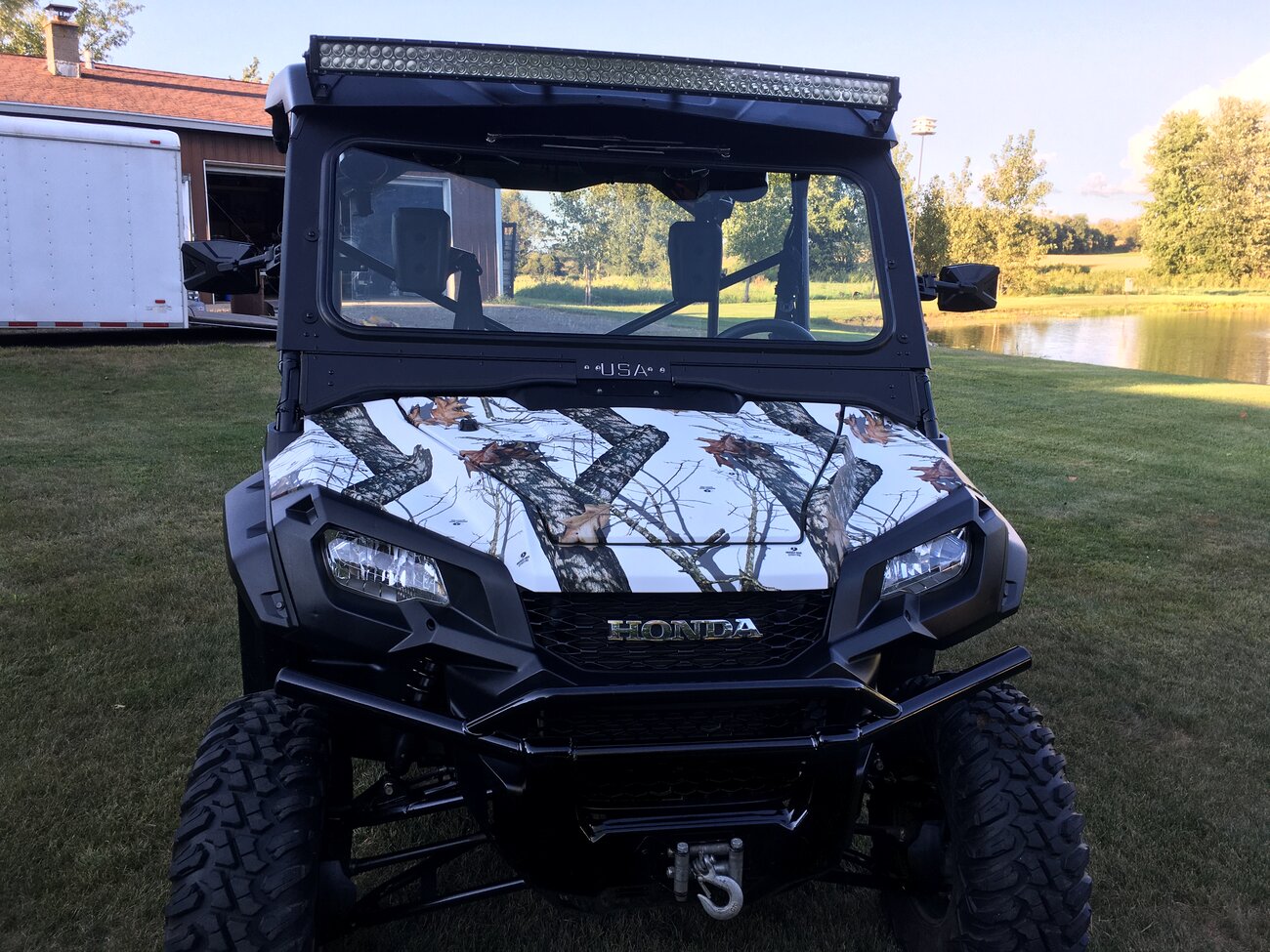

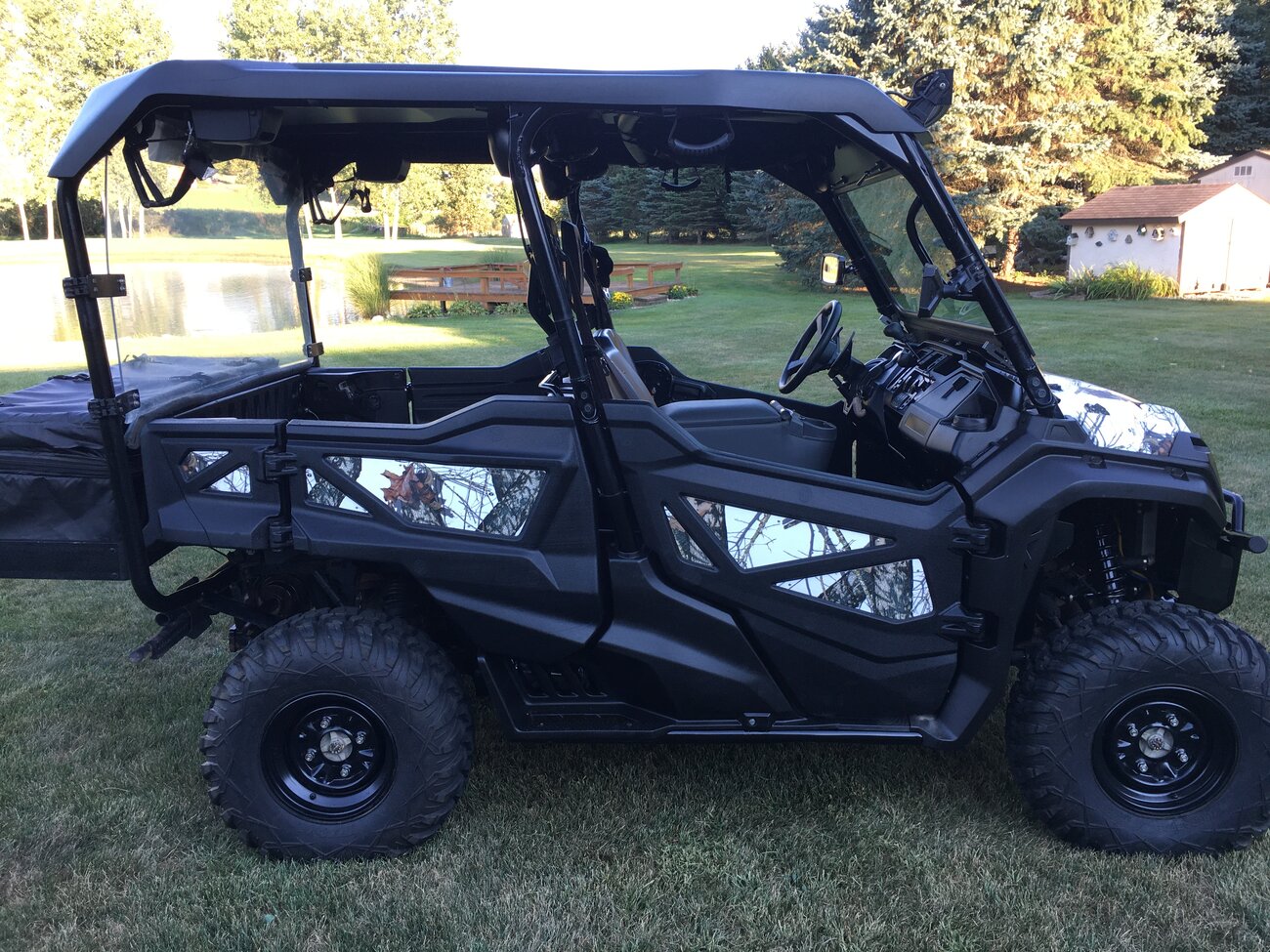

2016 Honda Pioneer 1000-5 11,000 miles. Recently had it wrapped! (was green) We have the service manual but couldn't find it in there. Was hoping someone knows! Has a rear wheel clicking noise, so took apart to check axles.
IMG 0922   Copy IMG 0925   Copy IMG 0928
View attachment 345029 View attachment 345030 View attachment 345031
Nice rig and thanks for the pics! I like the wrap!
