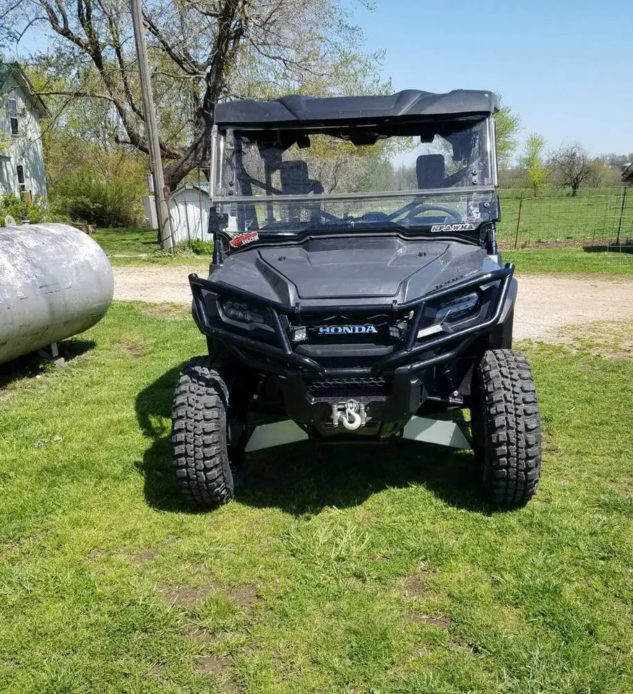

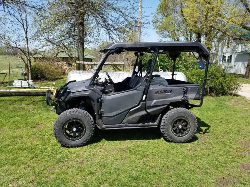

5x2 here's 235 /75-15 stock they fit but it's close Db8178c8b1f24812ab4ba024e56ff667377bf8a8666920fc93e8a9ee4874c39aFaeb4bb2addfb3591284e150a081f28b9f109c6a96f891354e177dba9801ca50

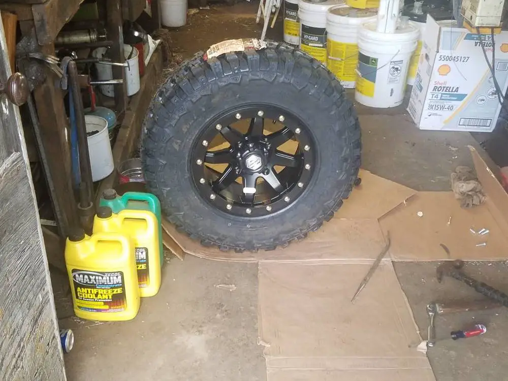

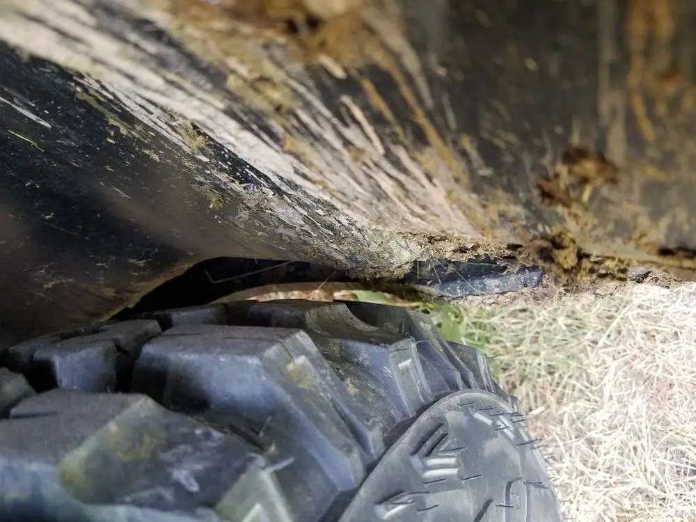

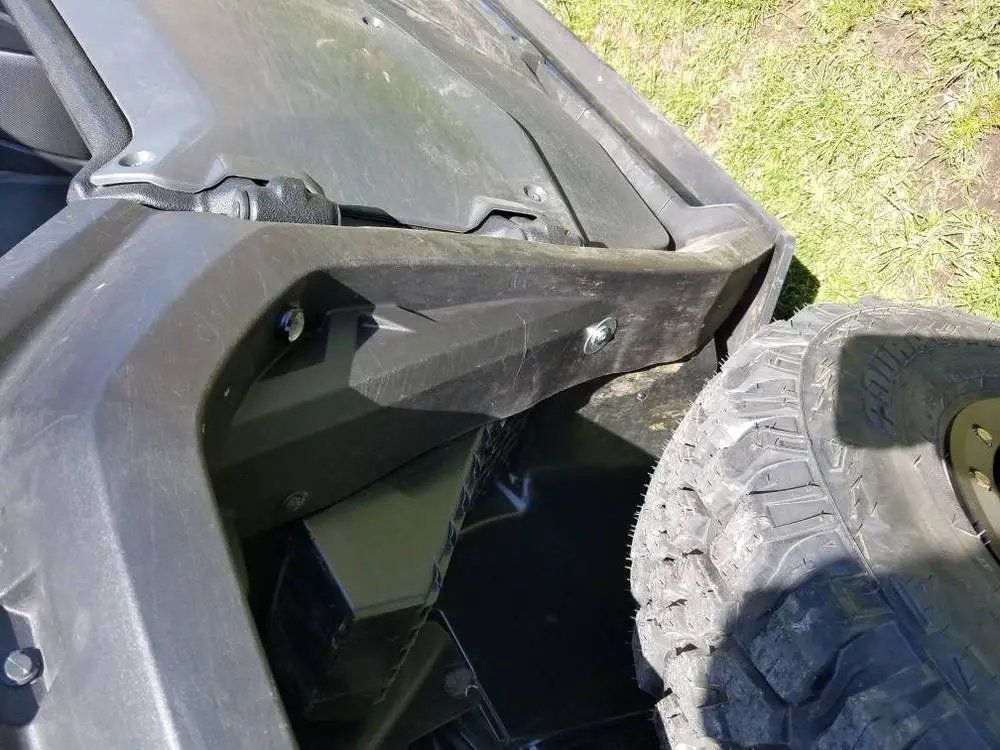

0 would be 3.5x3.5 that would make it more app to rub more rim further out from ball joint, they did take a little power but not bad in low on the trails didn't notice took a little from the brakes. As heavy as side wall it I don't think I would do bead lock again lot of work to get it right with truck tires. Took a little from ride too but much quieter and handles well on chip and seal .I did half to add one screw to keep it from rubbing finder flare.61ea71d41d387227db767f9c7021c839
