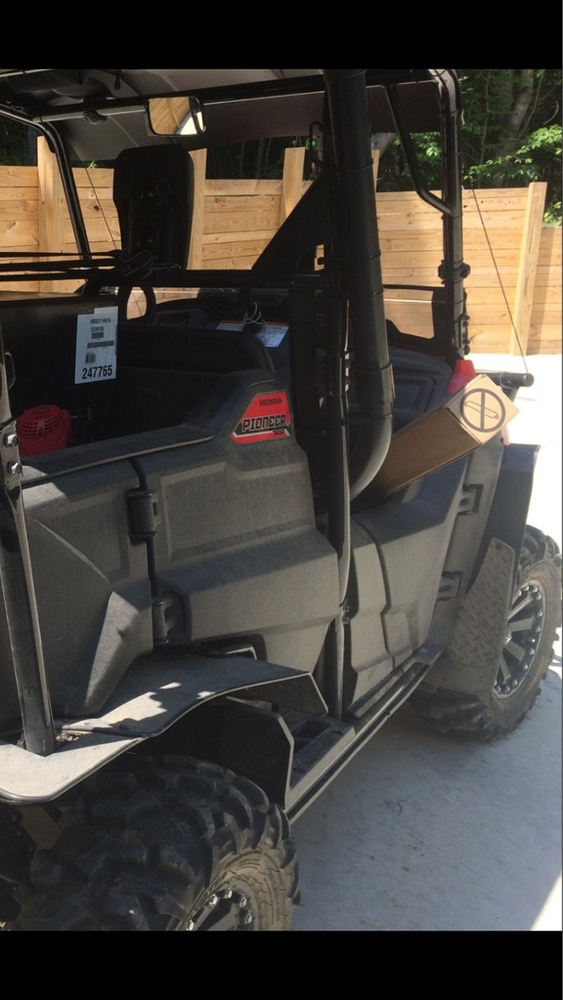

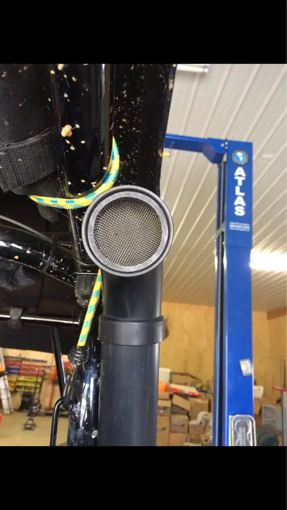

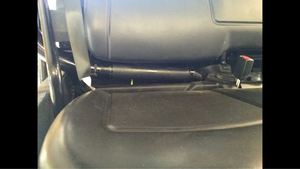

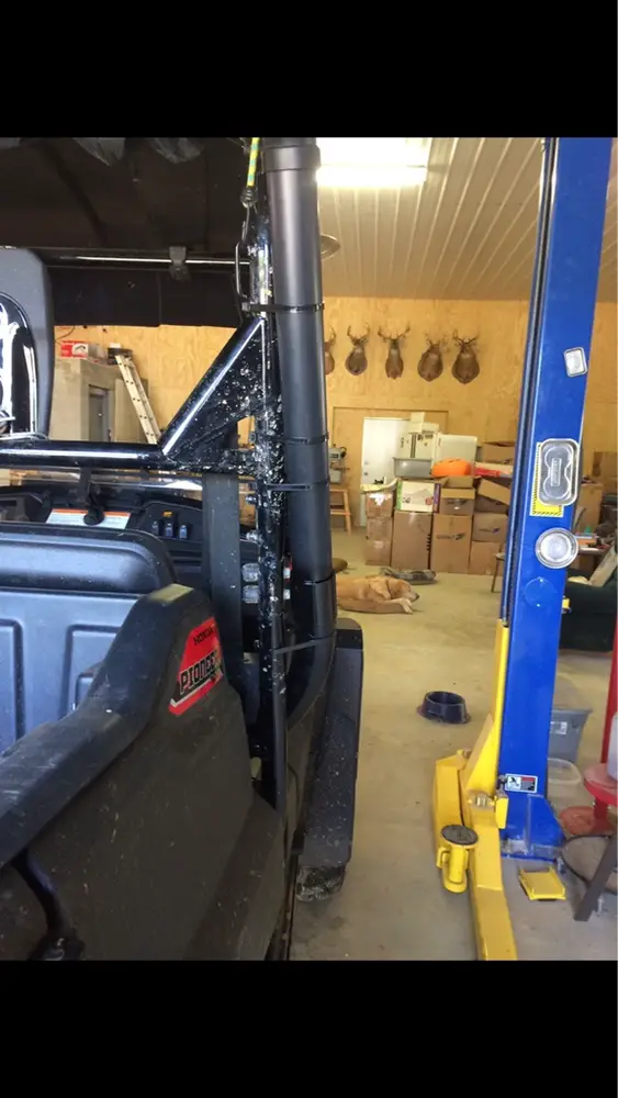

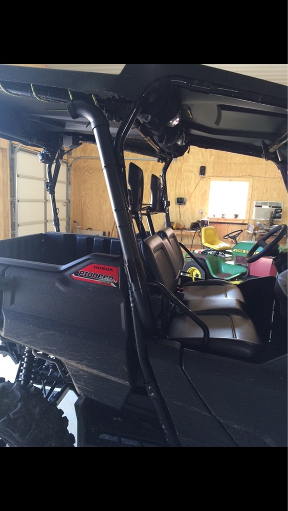

You may have already seen these pictures before but I went ahead and search for any pictures that I have, this is it.
059179cc89574c1a750882a452a8e0ef
73fb3dc9b56944d019b02637c66160d8
8ea8e2b00d77e58a5274bd3d12a2d666
6ee6979abee0d7b176afc728fc34f761
8ad15645687843a76f7b910a7899371a
Reactions: CumminsPusher
