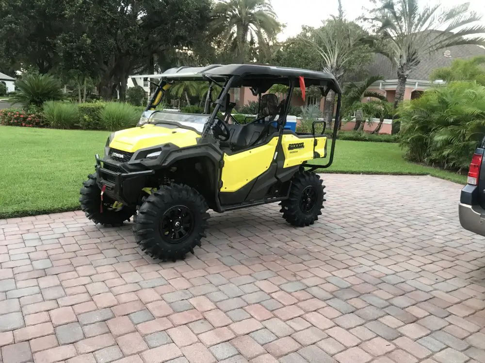

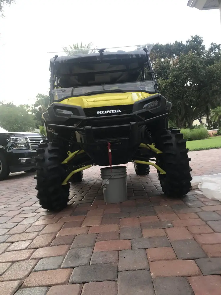

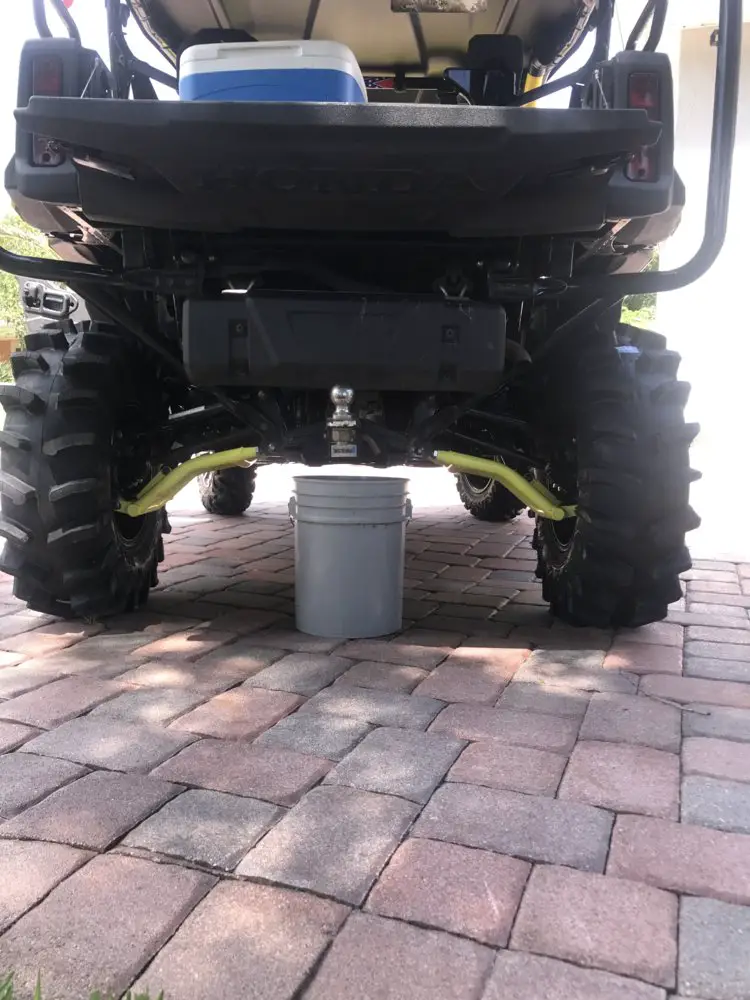

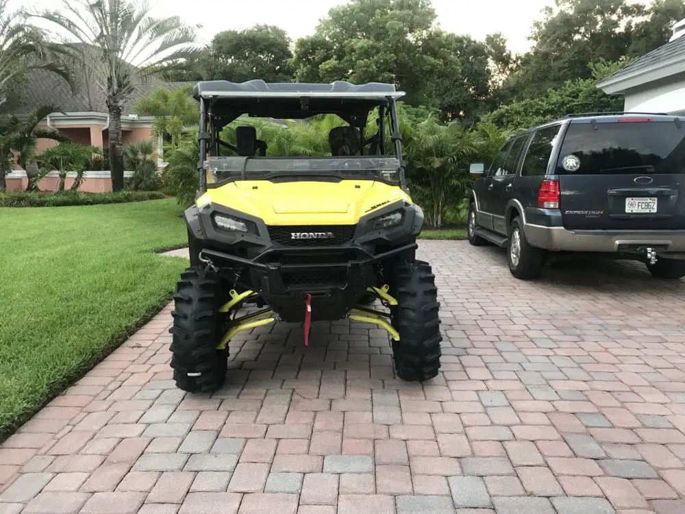

Just put everything on today! Have to do some adjustments to the c fab a arms but the system 3 xm310 tires were surprisingly smooth on the road for what they are I will do a tire review once I’ve actually used them
Here’s my baby and her new shoes and a arms
