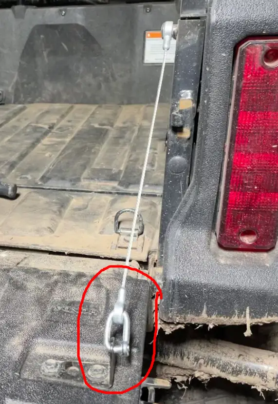

Just extend the existing cables. Go to your local hardware store and buy two cold shuts. Should be $1 or $1.50.
This is a cold shut. Have to double-check the correct size. Fairly certain it's 1/4".
Image stolen from this post. Credit to @toddvdh
That is what I currently use but I am putting together an idea currently and I might have 2 tailgates for my machine so I need a second set of cables and I figured I would just purchase the longer ones and be done versus another OE set.
They are currently listed on Amazon right now sold by Farmer002, so ...
