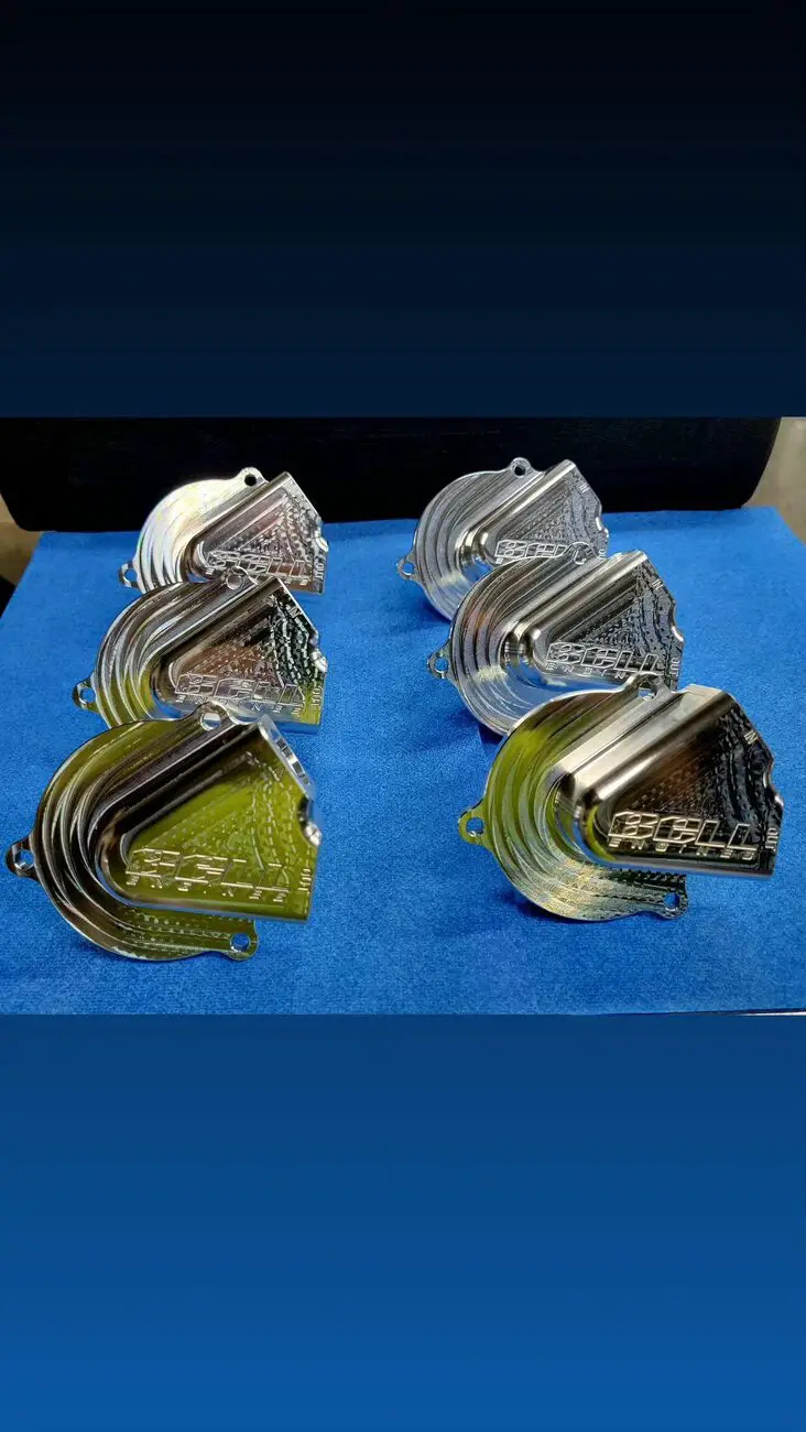

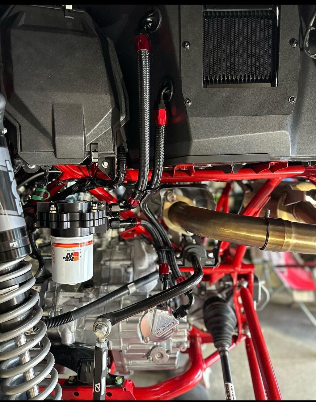

If you are like me and think that little filter is being asked to do a lot this might help. A way to add a remote filter and or a oil cooler if you choose.

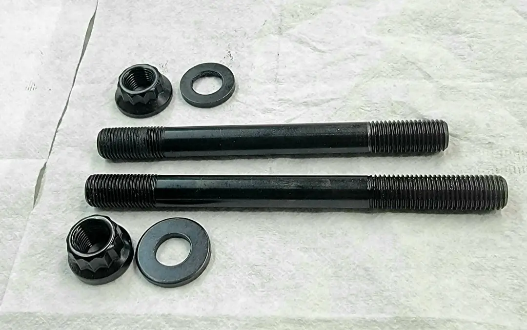

And for looks I'm working on a billet DCT filter cover also. I'm on FB under Bell Engine's or text 417-619-8514 I will fix you up. I can also fix you up with my custom ARP Talon head studs. They provide full thread contact in the block which means less cylinder distortion. I also had custom washers made for even load across the entire spot face of.
You can see the difference in the picture old versus the new custom stud also size difference between the washers & nut.

I have the Bell remote oil filter mount and the head stud kit on my race engine. Both are top notch and well thought out products. Highly recommend both!!

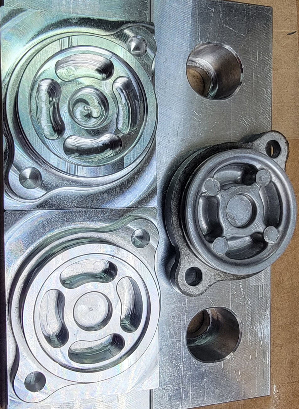

Can you post a picture of the inside of the oil filter bypass cover?
Trying to wrap my head around how it connects inside the oil filter housing for the oil flow.
I looked online, with no luck.
Thanks.
Have a good day
It has a tube machined into it with O-rings that seal around the stub that the oil filter slips on inside the factory housing. Oil goes in to the Bell adaptor through the tube, out the "out" port to a remote filter housing and then back in the "in" side on the adapter.
