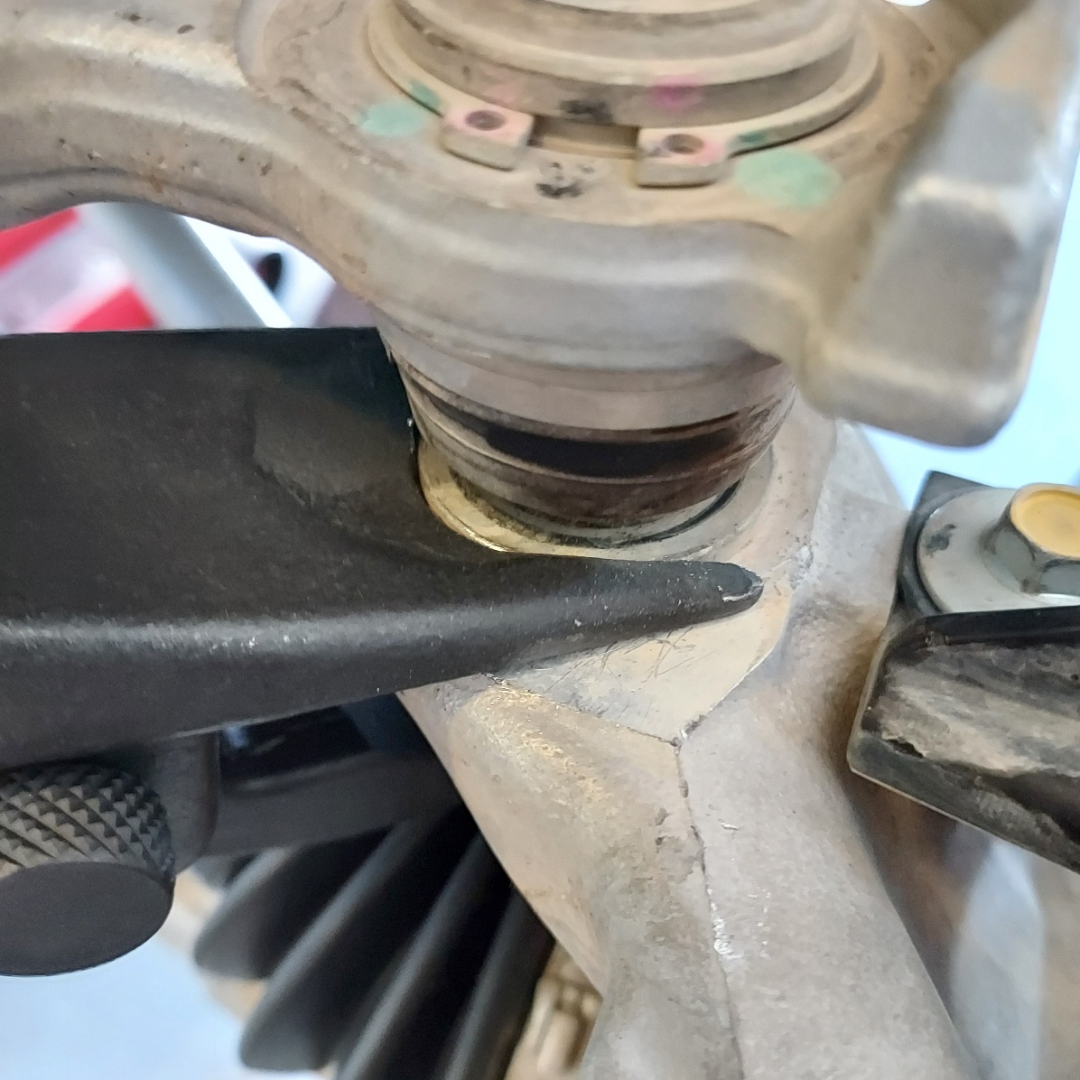

They are sealed so I never grease them. I don't drive in deep water, around 6 to 8 inches is ok for me. I just hate having the wheel bearings and drive shaft under water. It's usually sandy water here and it can be hard on the drive shaft seals. I modified a Harbor freight ball joint seperator to fit the Honda joints. I had to grind out the fork to fit.

View attachment 349807View attachment 349809View attachment 349810
A heads up on using these tools.
Don't use the nut that holds the balljoint in, use another nut you can throw away. I've crushed the threads on the orignal nuts before and they can't be reused.

I was on the shaft and used the nut to keep it from popping more then 1/8".
