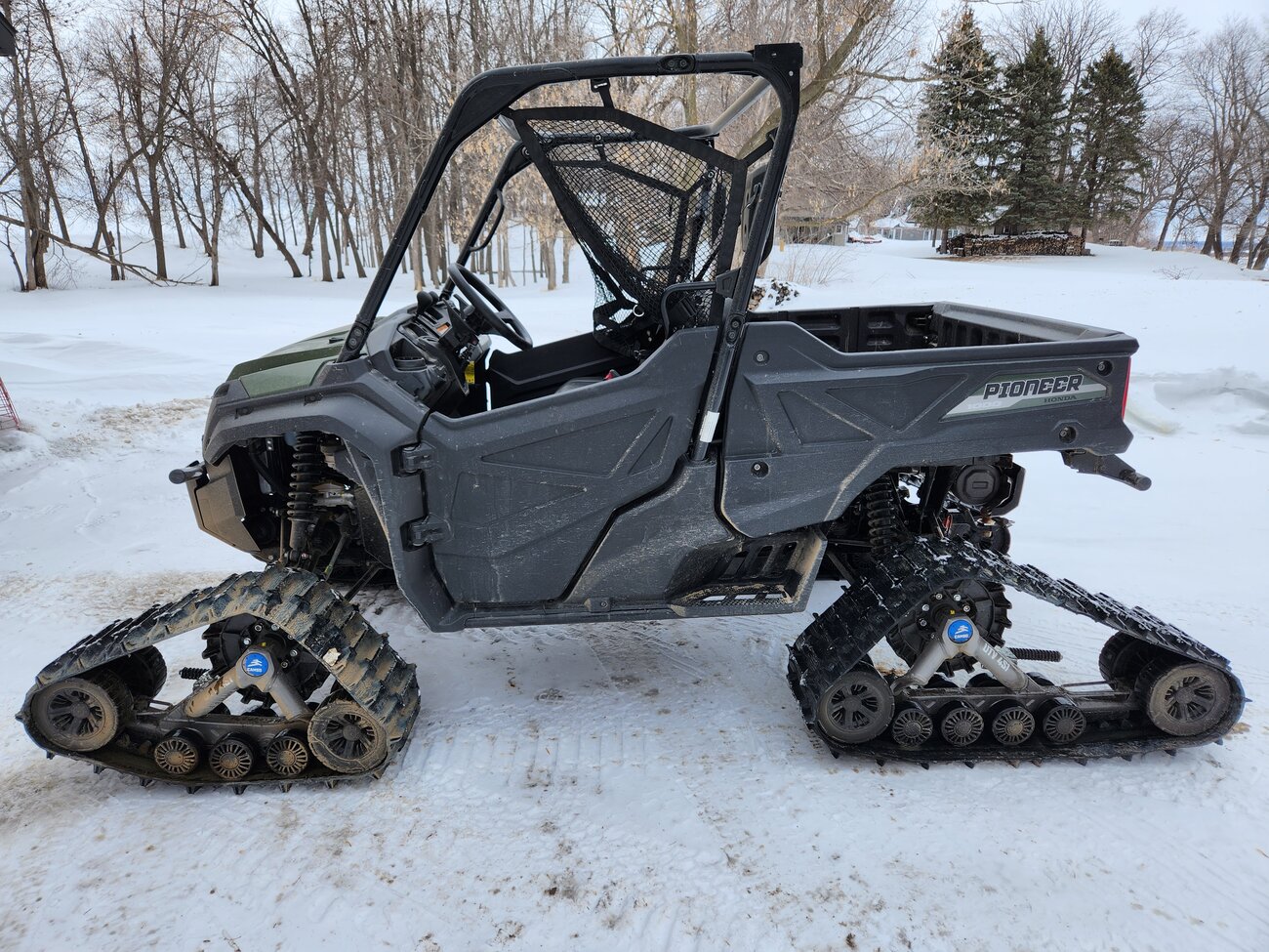

I only had the problem were it would kill when putting it in gear the one time. After that it was fine, never happened again. He time it did happen, it had ran for about 10 min idling while we torn down the portables to move.
The power steering issue happened intermittently except for the last day, where it never came on at all. It was also 20 above that day, dunno if that had anything to do with it.
Lastly, the transmission shifting issues happened towards the tail end of a 7 mile run. I had 3 guys in it, the back loaded with gear, and pulling a heavy portable house/sled. It only happened the one time as I ran it in manual for the remainder of the trip.
Here's a Pic with the camso 4s1 tracks. They work awesome.

Those tracks really work well. You are brave running them with an open cab, how long did it take you to fill the cab? Mine throws a ton of snow
