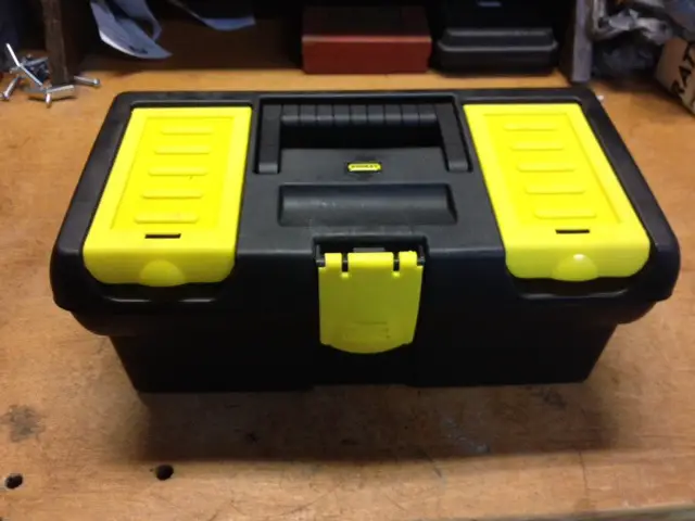

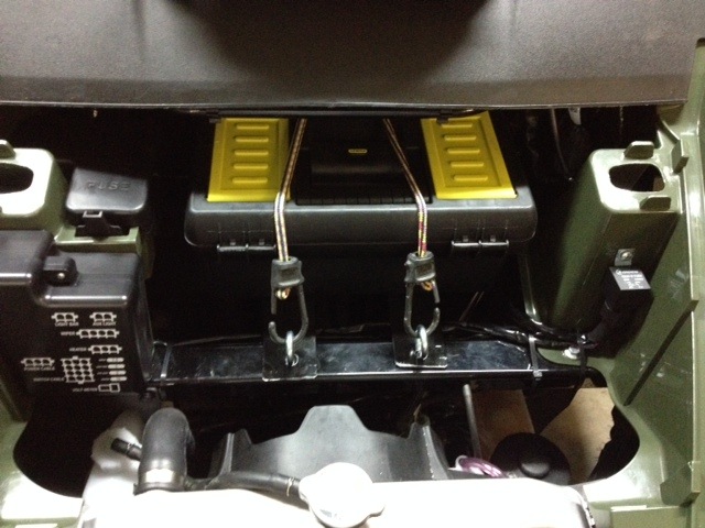

Wanted to make use of the open cavity under the hood. Looked for and found a small inexpensive tool box made my Stanley ( Somewhere in China ) that would carry some essentials. Basically, a flat head and phillips driver, a crescent wrench, channel locks, tire plug kit, electrical tape, fuses, and a large snatch block. Wasn't going to do major repairs out in the field, but just a few basic tools.

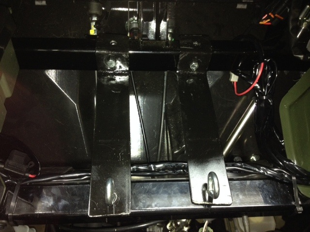

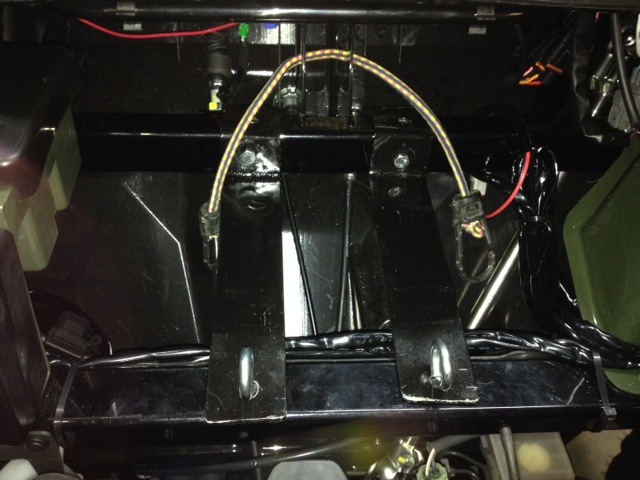

Took some thin flat bar bought at home depot, heated it to make the bends and drilled out some mounting holes on the two square tubes. Bolted down the rear side and up front bolted it down with eye bolts. Ran a bungee cord around the vertical frame and back to the eye bolts.
Works for me!

Nice work bigriver. Fairly simple design and you can remove it fast. Something I am going to have to look into.

What I like about my design is that I can remove it for accessing what ever is in it, it didn't cost much to put together and it ain't going anywhere.
