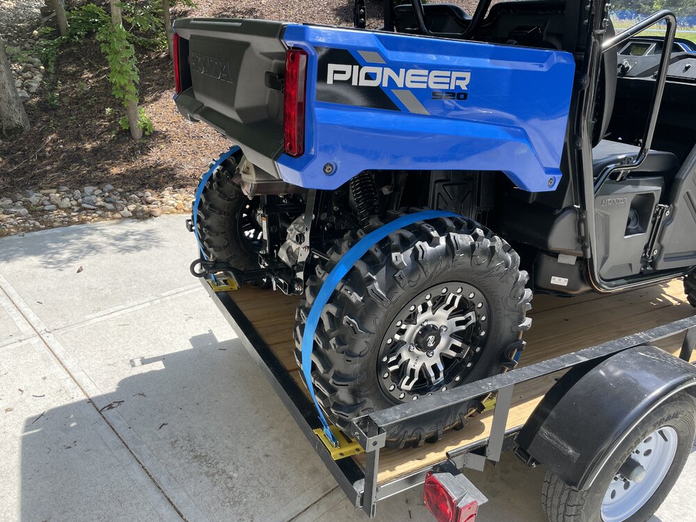

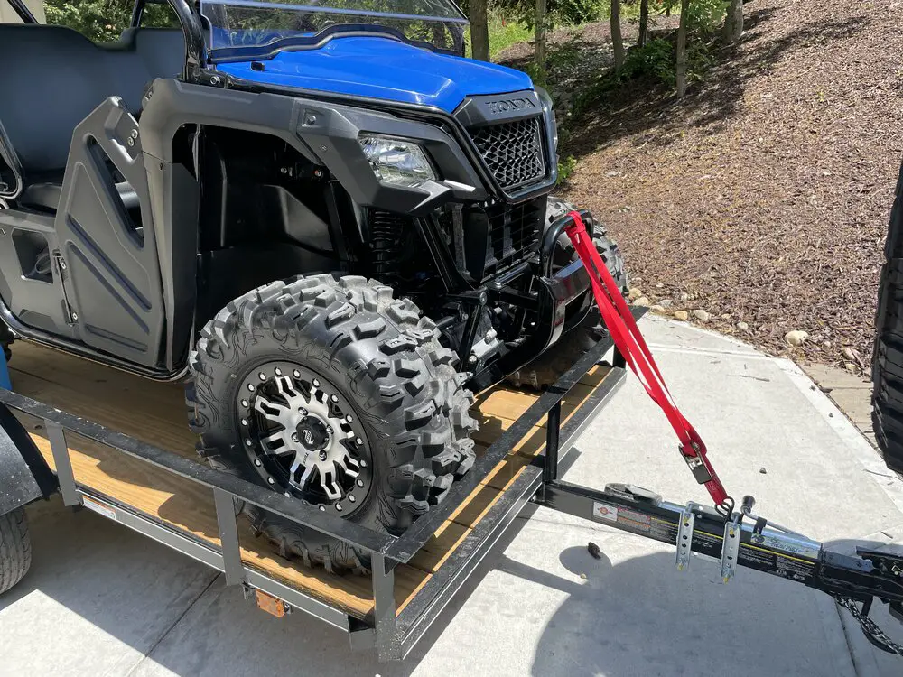

Trailer with P5Cargo Buckles
Aerolite
Aerolite
Jan 10, 2021
114
499
Oxford Mills ON
I just refurbished a trailer I got and put etracks in. Did a trip last Wed with a total of 3 hrs in trailer. 520 never budged at all. Super easy and quick to tie down. I also just snugged the straps down until they were tight and that was it.
This is basically the way cars are strapped onto flatbeds now. I really like this as there is no stress on any parts of your machine, and it just rides on its suspension over all the bumps.
The close up pic was just a pic I found as I only have the pic of mine sitting in the trailer. I’ll take better pics the next time it goes in the trailer.

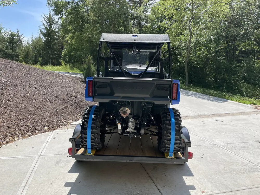

Hi all,
I just took a trip that was about 140 miles after I put this all together this morning. My 520 didn’t move at all. Pretty easy to install on the trailer itself.
I will say that my trailer is damn near too small to haul around the P520, But I think it will work for the few times that I need to drag it around.
