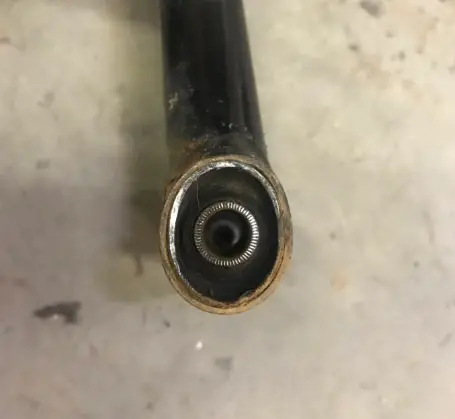

I had already added some more Weld and small gussets in the past and I think that’s what prevented the tabs from ripping completely off and so the damage was then transferred to the bushings and it also bent the bolts.
