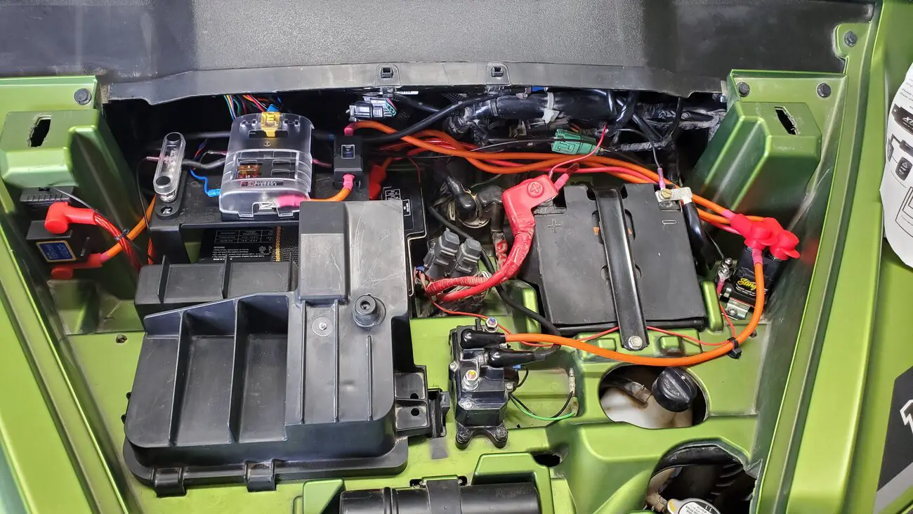

I used the Honda amp/fuse block platform (for the 22+ P1Ks) to mount my Blue Sea fuse block, fuse and ground buss bar over the Mighty Max battery that I put in the well. I strapped the Mighty Max down with a marine battery strap that i dremeled holes into the bottom of the well to secure the strap. I mounted the smart charger on the left side and a Stinger isolator/relay on the right side. The Stinger relay only sends power to the Fuse block when the vehicle is on and all my audio and accessories will run off that.

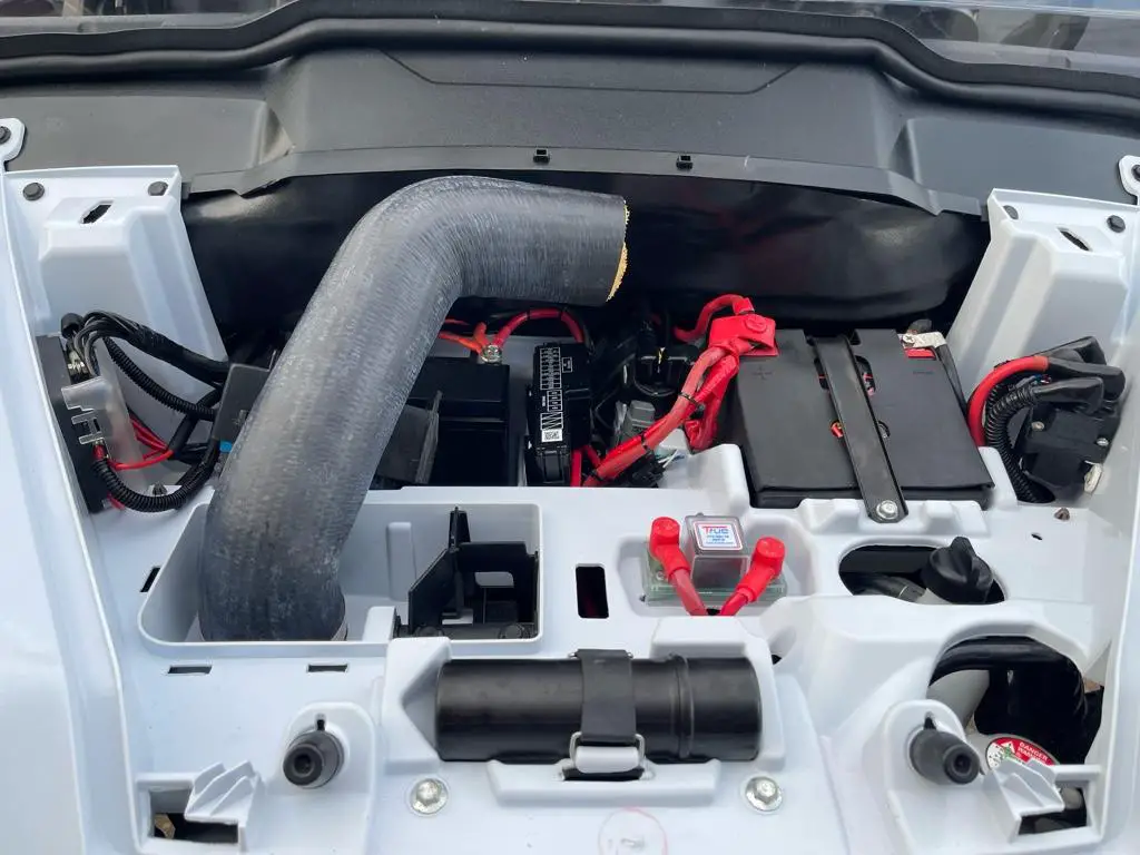

It’s a bit of a mess. Wish I had planned better.
