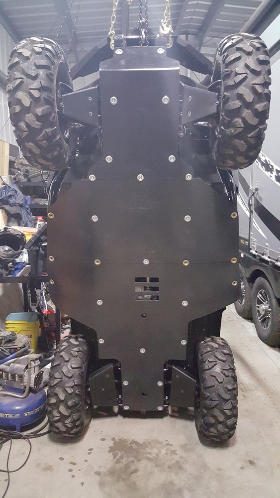

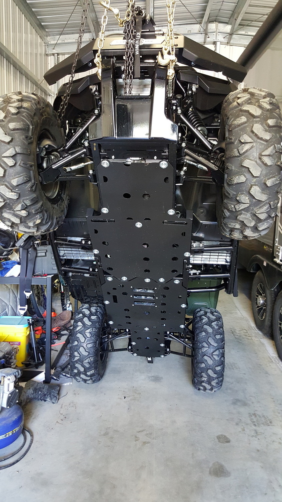

I would highly recommend a good set of UHMW full skids & A-Arm protects as one of the first must have add ons' for the P500, just like a roof protect you from the sun and rain the skids protect the machine from rocks and sticks. Below are OEM skids to UHMW skids night and days difference in protection.
Before, OEM Honda Skids:
20150810 165249 zpscbj0hry0
And AFTER SSS OFFROAD UHMW SKIDS:
20150810 204140 zps0mypctif
