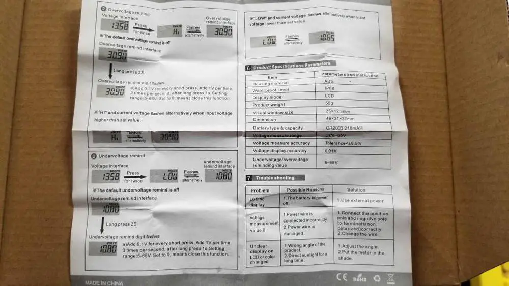

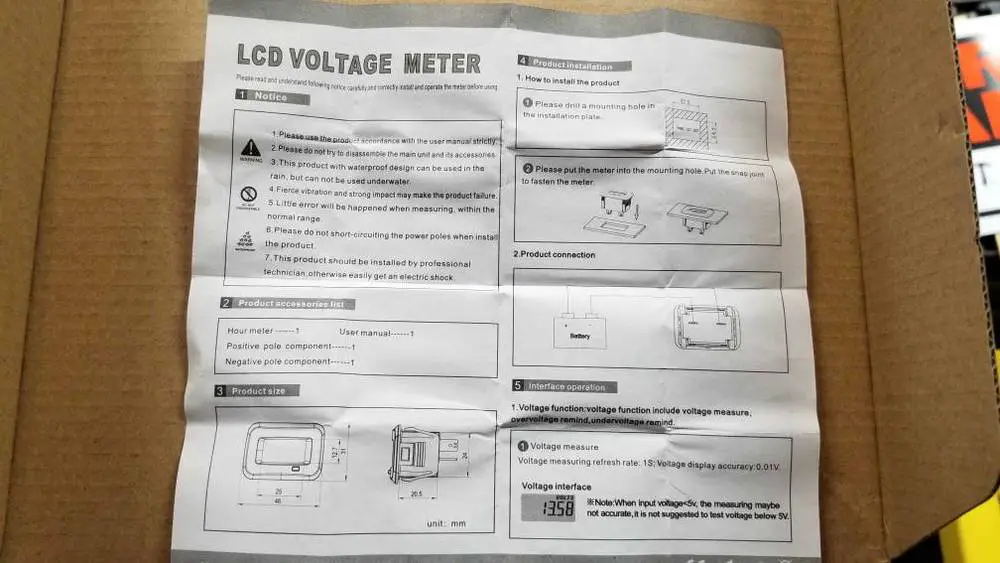

Did anyone save the instruction for the volt meter that goes with the dash plate? I installed it and when it worked, I guess I did not save them. it show hi sometimes even at idle, and I was not sure if there was an adjustment on the high number. voltage running 13.64 so not that high.
18,452
66,870
I just happen to have them. 1e53513eee227c3fa75c1d7b1ab7ce64865435d9451585a5f23cefc8e680b2c0
Reactions: Hawk53
18,452
66,870
Also. For those wondering if it always stays on or not.
Yes it does.
Its internally powered so it is on even when disconnected.

An automotive charging system will charge at 14.2 volts so that not not high at all. The system has to have higher voltage than the battery to charge.
