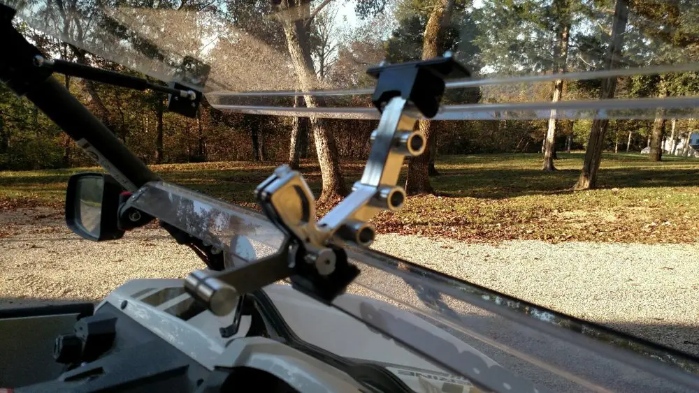

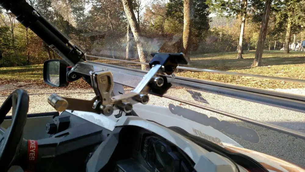

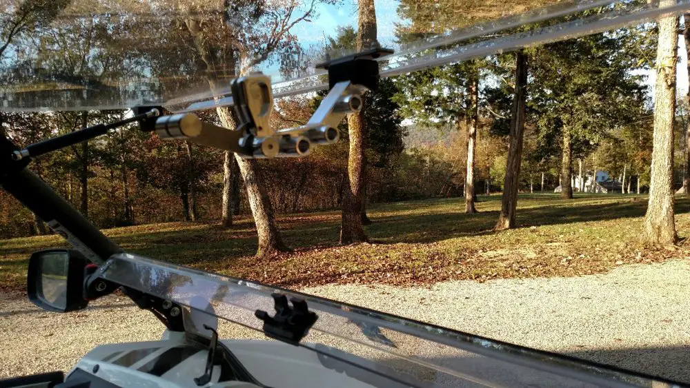

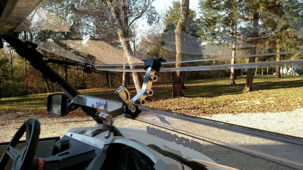

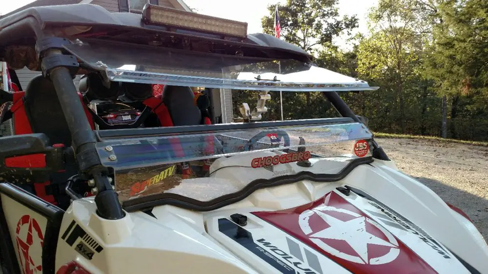

First off I found my spring.
Second, chamfer chamfer chamfer shoulder bolt.
This product is very well thought out, designed, and machined. I'm not an expert but I spent 26 years as a machinist and cad/cam manager. This is Avery nice product. To keep spring from popping out I put a pin in the hole to to hold spring in. Once in place of the bracket I let the bolt push the pin thru and out. I also taped a piece of cardboard on the spring to keep from scratching the windshield. One installed I removed cardboard and put a small rubber stop on the windshield. So far I'm digging this add-on. Good job Cliff.

I believe we are going to start supplying a chamfered shoulder bolt with it. Also adding shrink tube to the long spring end.
We are supplying little rubber bumpers now that go on to the windshield if the adjuster hits it. Kinda strange that it does not hit on my machine unless the HDDH is in the all the way up position but seams to on others ?
Rubber bumper
