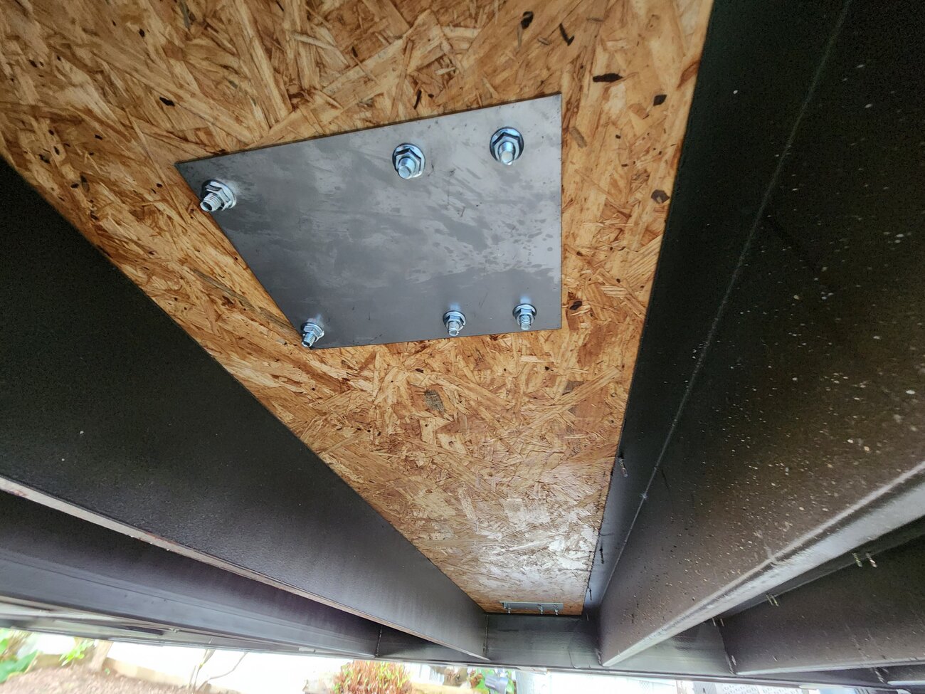

Decided to add a set of Rhino wheel chocks to the Cargo trailer. Have a set for the rear but figured one set in the front would be enough with the rear secured. Replaced garbage hardware with stainless 5/16", rather than the M6 or 1/4" soft garbage that comes with the kit...back to work.

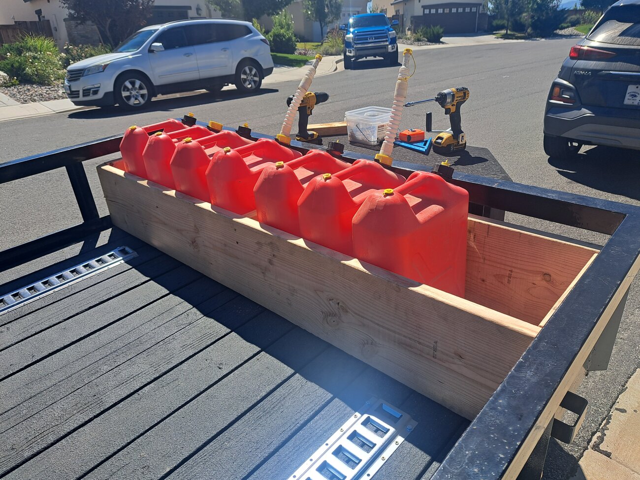

Got my trailer deck finished. Coated in a super grippy covering designed for wood decks. Has a bedliner finish to it. Then built a rack to hold my gas cans and finished it in the same coating.
Looks good 👍
🤔....you gots a landscape business? 😳 that's A LOTTA gas......

Unfortunately a lot of the places I go (particularly hunting) are so remote it might be 100 miles to the nearest gas station.
I also tow with a gas pickup, so it's nothing for me to burn through many gas cans in a week.
Gets expensive. :(
@Dirtstiffs-1000 , Some very nice looking work there!
That said, I'd be concerned in the unlikely event of a high energy accident. Kind of a PO'er trailer manufacturer's would stoop to save maybe 40% over plywood cost by using OSB. That, and then installing the deck with self drilling screws to the thin sheet metal lateral supports. You've used good backing plates, but those may pulling through that OSB, if it doesn't just pull out or shear sheet metal screws.
I'm no mechanical engineer but in a 30 mph barrier crash, there's 30 G's to deal with. The Honda SXS is gonna exert up to 57,000 pounds on whatever is restraining it. Of course that's a 30 mph worst case, but no matter, the forces involved in even relatively minor accidents can be astonishing.
