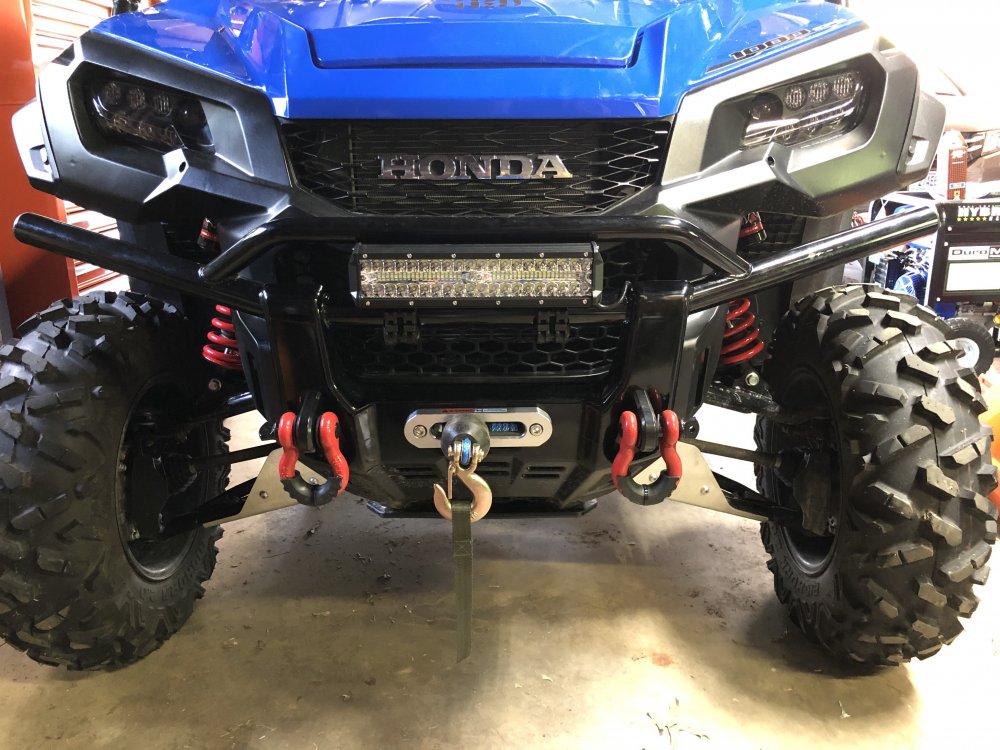

Winch, shackles and led light bar installed, next is a switch plate and radio👍🏻

Looks good! What winch/mount did you end up going with?
I ended up using a Viper Mount. I'm still not thrilled with how the the setup is with the factory bumper but oh well. I haven't got it wired yet because I'm brainstorming on how to do the wiring with a future radio. Should I get a fuse box???

I think yes on a seperate fuse box.
Everything I run in accessories including my winch are on a completely separate battery and switch circuit. Never killed the aux battery or main using winch and accessories.
I like being able to completely seperate accessories from the OEM electrical circuit.

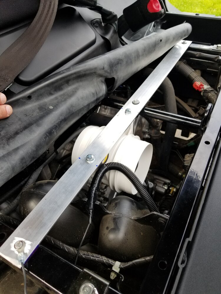

Out of boredom today really, I decided to do the 4" bilge blower under seat mod.
My wheeler came with the Honda heat fix but the back and seat still sometimes get toasty when hot outside.
6 months ago I added heat shield/dyna mat material under the seat and seat back and it works pretty well.
We still get a warm blast once in a while from the back when hot outside, so I decided to mount a bilge blower.
Blower delivered tomorrow, but it's wired, switched and ready to install.
I did also cut to fit a car window shade as an added measure. Copied another's idea. $13.99
