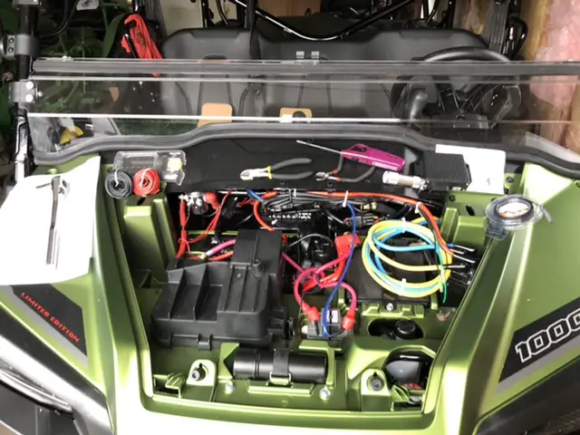

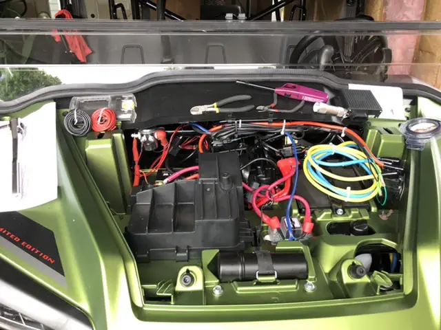

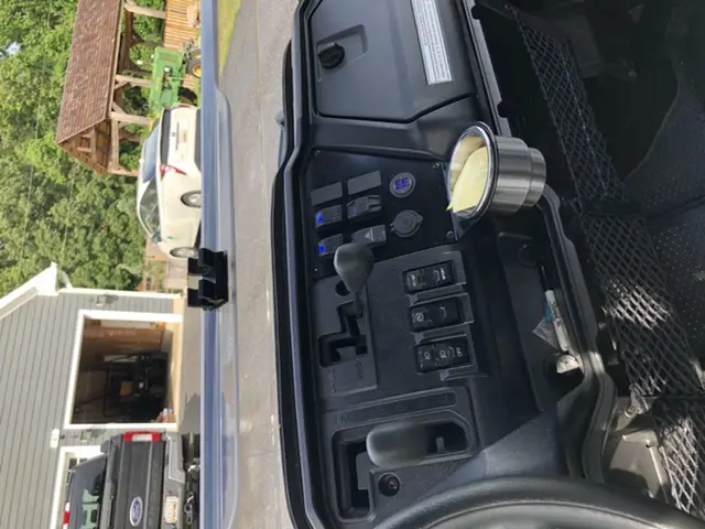

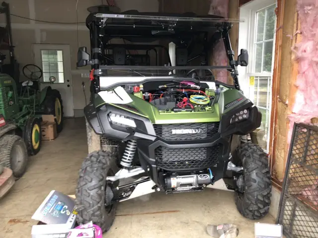

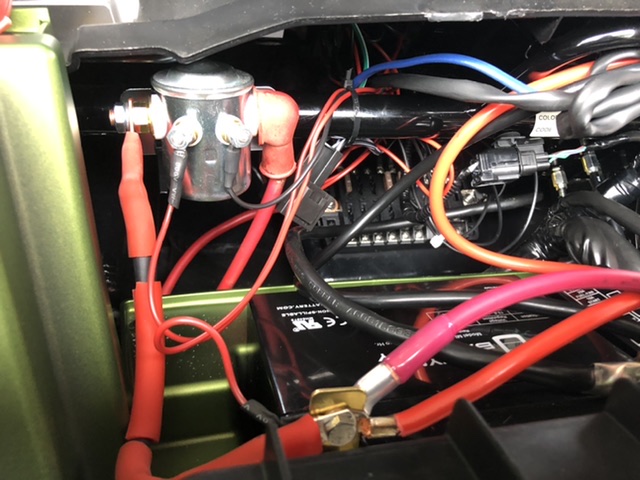

Spent today installing all the parts I didn’t know I needed until I started lurking around.
oem roof, super Atv windshield, chupacabra mirrors, viper 6000# winch, dual battery set up with isolated and PBR switch plate. Tomorrow cup holder upgrade and e-trac system for the utility trailer. Who knows I might even find time to drive it......and the neighbor stoppedby to show off their new to them 720 diesel which was awesome!

View attachment 208845 View attachment 208846 View attachment 208847 View attachment 208848 View attachment 208849 View attachment 208850
Nice work.

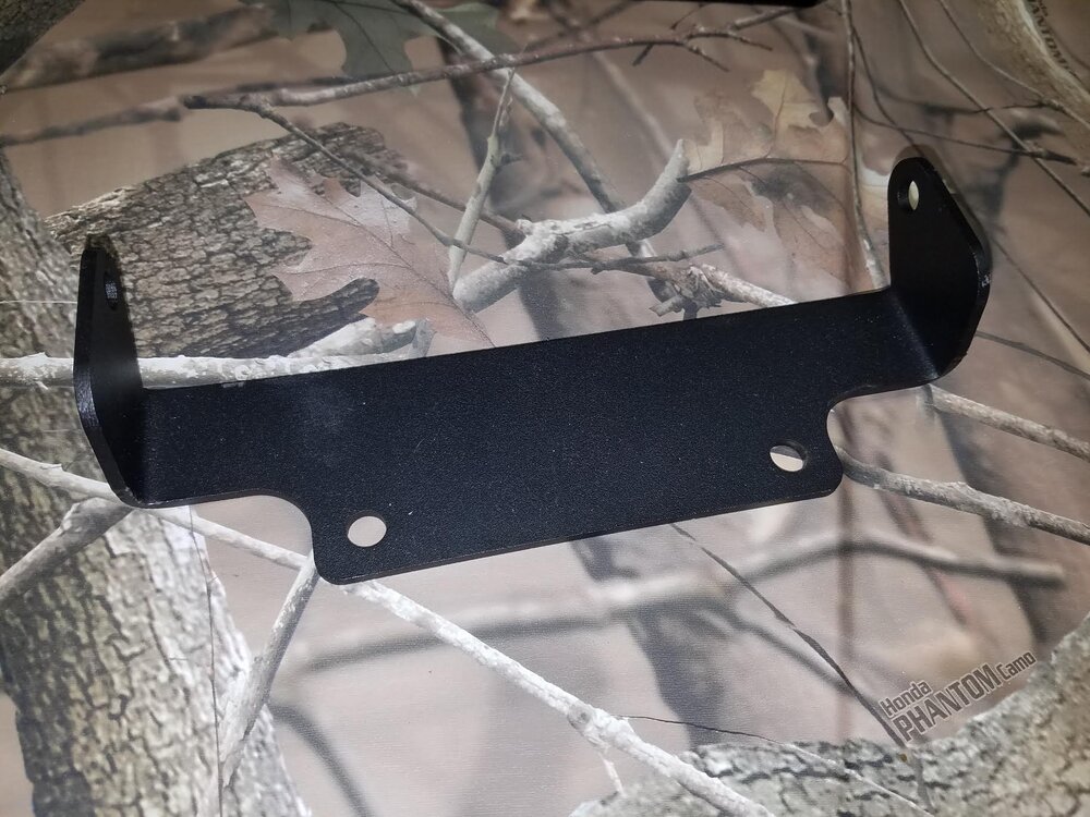

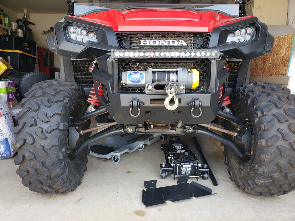

Not on yet, but warn bumper came in. Waiting on sub tranny parts to put it back in first. Will have to figure out how to close off the gap under the new bumper. Superwinch fits.

Bumper and winch on with new rope and hawse fairlead. Made "pedestals" out of 1x1 angle to mount the 20" RC light bar above. Skid plate not on yet.
20200627 172317

why didnt you put the lower part of the bumper on ?
I will, but waiting on sub tranny parts to come in so I can put it together and back in. You have to unbolt the front diff and slide it forward to remove the sub tranny.

  2. Talon X LV
Oh ok, I learnt the hard way that it wont go in after the top piece is in place
That's good to know. I just have the four bolts that go into the frame snug, not tight yet.

Did you get the light mount with your bumper ?
The 90 degree ears came with the light. I made the risers/pedestals from 1x1 angle and 1" strap to close in the ends. Rattle can bed liner on it.

I like that. I think im going to find a light to fit the mount I got with my bumper
