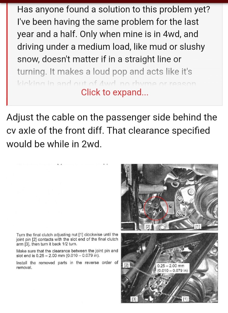

Try this. My 2018 made some pops and clunks when I tried to put it in 4wd one time. I did these adjustments on the front diff and no issues since
Screenshot 20220429 211040 Chrome
Screenshot 20220429 210930 Chrome
Screenshot 20220429 210822 Chrome

It could be. Start with those cable adjustments since that's something easy to check. Also when you're in a tight spot like going through a ditch or up a steep hill or over a log, put it in low range. This will help to save your clutches.
Another thing is be sure you have the updated clutch cover. The 2016 year model had issues with that. You can search on this site to find a picture of what the updated cover looks like.
