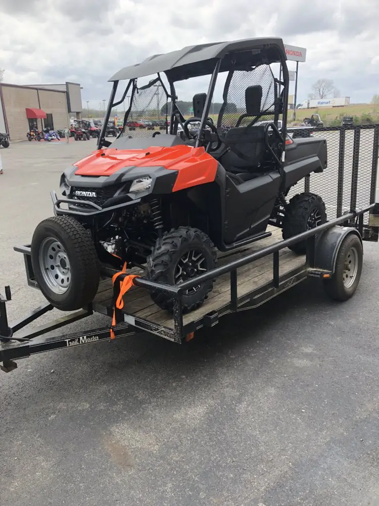

Good evening! Just purchased my very first Honda atv/sxs ever! Traded my Harley in on a a 2019 pioneer 700 deluxe. Which is super sweet I love it. My question is, will 27” tires fit well on the deluxe wheels? Not sure what the offset is.
Does anyone have a setup using the stock deluxe wheels? If so could you drop a photo!
Thanks y’all!

think the delux are the same size and offset as steel, tons running 27s, I am as well 9 in the front 11 rear,has a ton of clearance

I also have the deluxe and those are the size that on my in avatar! No rubbing at all, no power loss.

there is no difference really. might be 1 inch off difference on offset. but 27s will fit either way. 10s front 12s back on my 700-4
