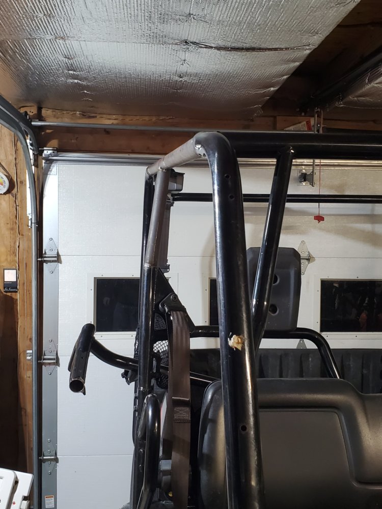

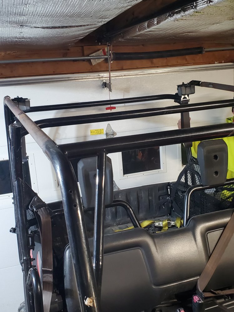

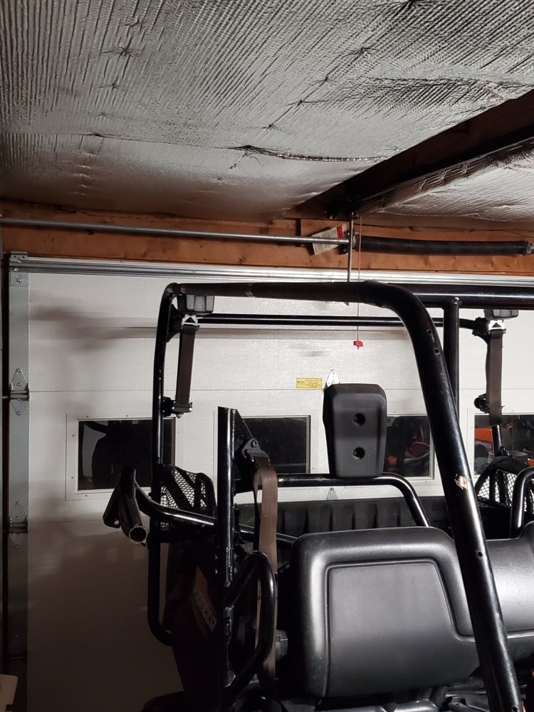

ByronM I just picked up a '17 700-4 about two weeks ago after owning a 1000-5 and a 500. No secret that the 700-4 has the ugliest design out there, so I decided to get rid of it too.
I knew I wanted a glass windshield so going low wasnt an option. Plus I feel like the seat is taller than the 1000 so I think headroom would be kind of tight. Also we dont get crazy and hard core so simple and a little tougher than oem is all I needed. Plus a flat sheet metal roof that serves the purpose. Here's what I came up with this weekend.
FYI, with the oem 1 5/8" O.D. tube 1 1/2" O.D. fits perfectly inside so theres no need to sleeve cause you already are. Plus the weld joint is a great fit all the way around. I did recess the tubes about 1" in every joint. The middle bar had to be tipped in slightly due to the new outer runs being true and straight. Looks so much cleaner without bolts, brackets, and little clips everywhere too!

Thanks Boilers. Are you planning to use a stock windshield? Modify the lower panel?
41,783
319,887
FYI, with the oem 1 5/8" O.D. tube 1 1/2" O.D. fits perfectly inside so theres no need to sleeve cause you already are. Plus the weld joint is a great fit all the way around. I did recess the tubes about 1" in every joint. The middle bar had to be tipped in slightly due to the new outer runs being true and straight. Looks so much cleaner without bolts, brackets, and little clips everywhere too!View attachment 187585View attachment 187583View attachment 187586View attachment 187587View attachment 187588View attachment 187589
Looks good, I like that on the 700.
I know you weren’t going to drop it down for headroom but the glass is no problem. We have Honda glass and it’s simply a flat steel frame so I cut it down then brought a cardboard cutout of the glass 5in removed in and it was about a hundred bucks. Went tinted glass too which is nice.
