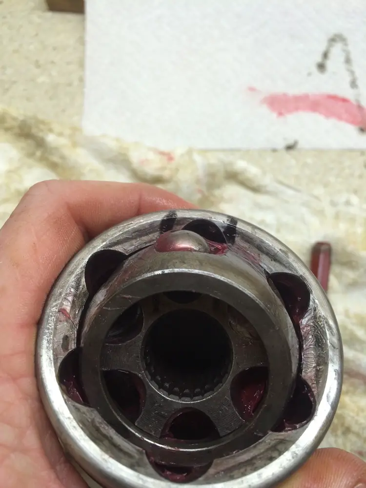

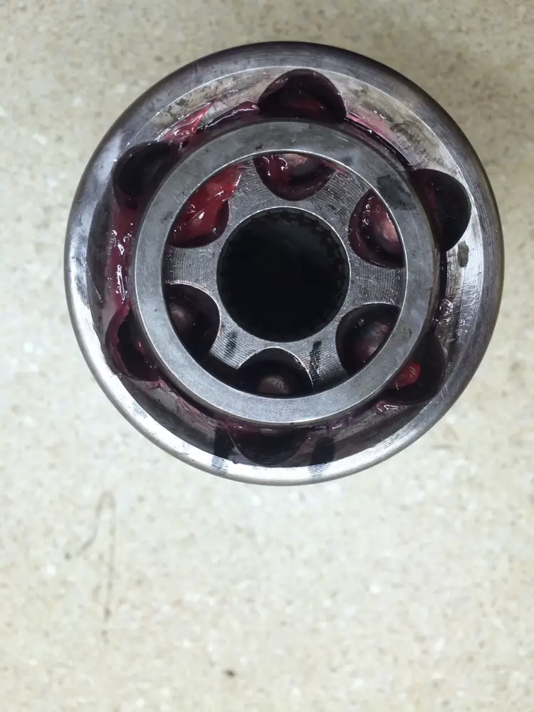

Reassembly is pretty straight forward. Just be sure to use grease everywhere prior to reassembly.
Here it is all back together.
The next step is to wait for the UPS man to bring the new boot.
More to come.....
Joe
