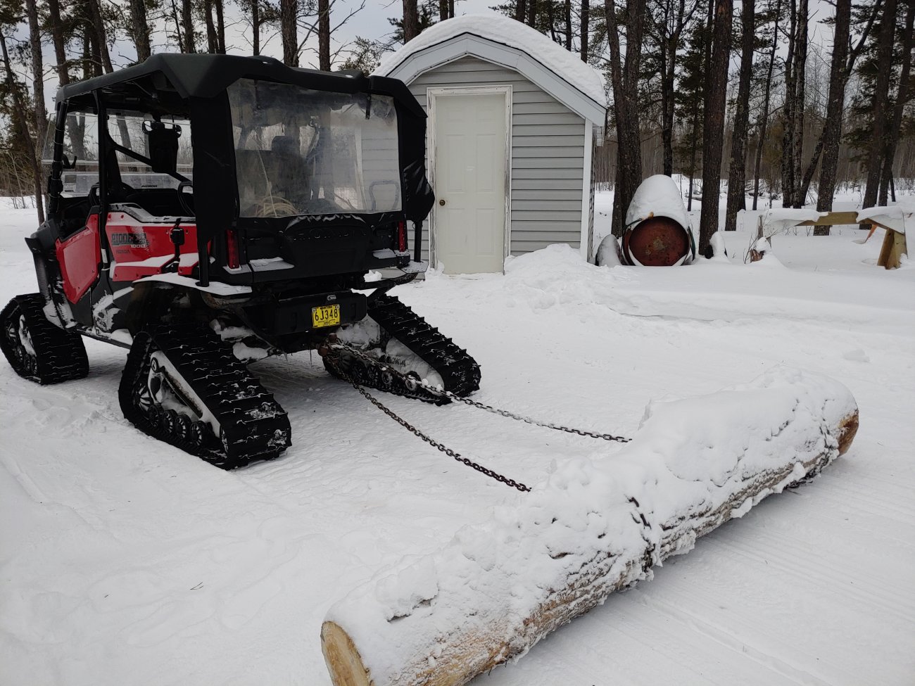

BTW, any pics of your rig?
been here since 17’ and all you have is a pic of a quad!

My first quad was a 1998 ES 450 Forman that I put 15,000 Miles on. Then a 2005 Rubicon also for 15,000 which I still have. Then a 2016 Pioneer 1000-5 that my son drove through water and hydro lock it and blew the engine. I now have a 2020 Pioneer 1000-5.
Since my engine issue I changed the fuel injector plugs and wires, air filter, relays for fuel pump and inhibitor. My next thing will be looking for bad or loose ground. Were are from South East Manitoba.
