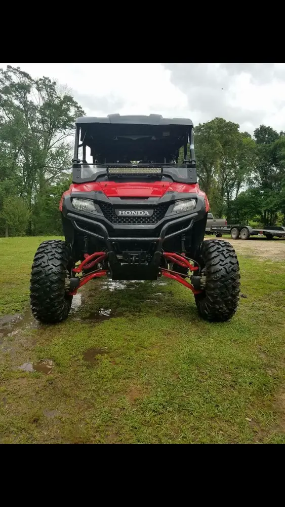

Allow to run larger tires without rubbing the fender.
See the pics below. This is a 30" ITP EVO on a P1000 with no lift. It is very close to the back of the fender where the floor board is. By moving the tire 2" forward, you can reduce the chance of rubbing.

More ground clearance and stretched wheelbase. You can fit larger tires without a lift thereby keeping your center of gravity low. And the stretched wheelbase should make it ride a little smoother. Did you notice that at all @joeymt33?
39,123
Some lift is required for larger tires. The stock tires almost make contact with stock suspension so larger tires and no lift would probably make contact even with forward arms
39,123
I'm not sure if I can tell a difference in the ride.
The main difference I can tell is that I have a lot of squeaks with the Heim joints and I can't use a arm guards.
