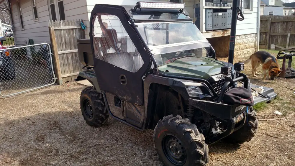

I have 27s on stock rims works great no problems at all. I kept 10 wide in rear and 8 up front. 10 psi in each. Goes anywhere!!!

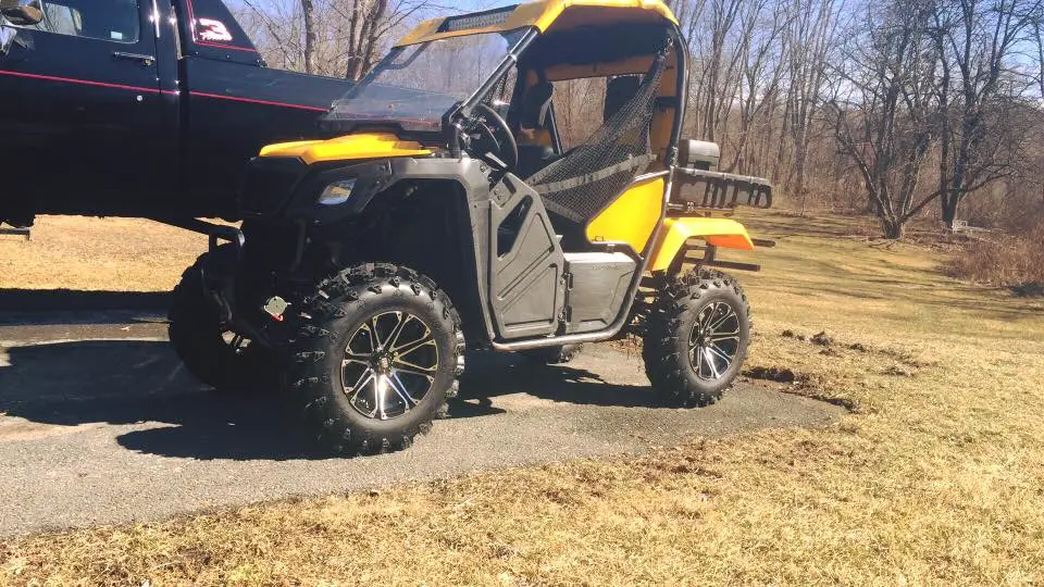

I'm running 28-9-14 all around went up 1 click with rear springs and unhooked swaybar I couldn't be happier almost 12" of clearance amanzing handling and not tippy at allView attachment 13019
How does the P500 handle those big 28’s? Did you lose much power for climbing hills or did it affect trail riding any?

Seems like that' the way to go then I have to get off the ground a little more. Do they make it much wider?
I went with new wheels with the Yamaha style offset, 4+3, at the same time so it is wider. It seemed like it calmed it down, made it smoother shifting, driving, etc. I'll see if I can find a picture

I have 27s on stock rims works great no problems at all. I kept 10 wide in rear and 8 up front. 10 psi in each. Goes anywhere!!!View attachment 12219
Hi just wondering if you are still happy with your tire choice? Would you do anything different? How much clearance do you have at the rear hitch to ground? Thanks!
