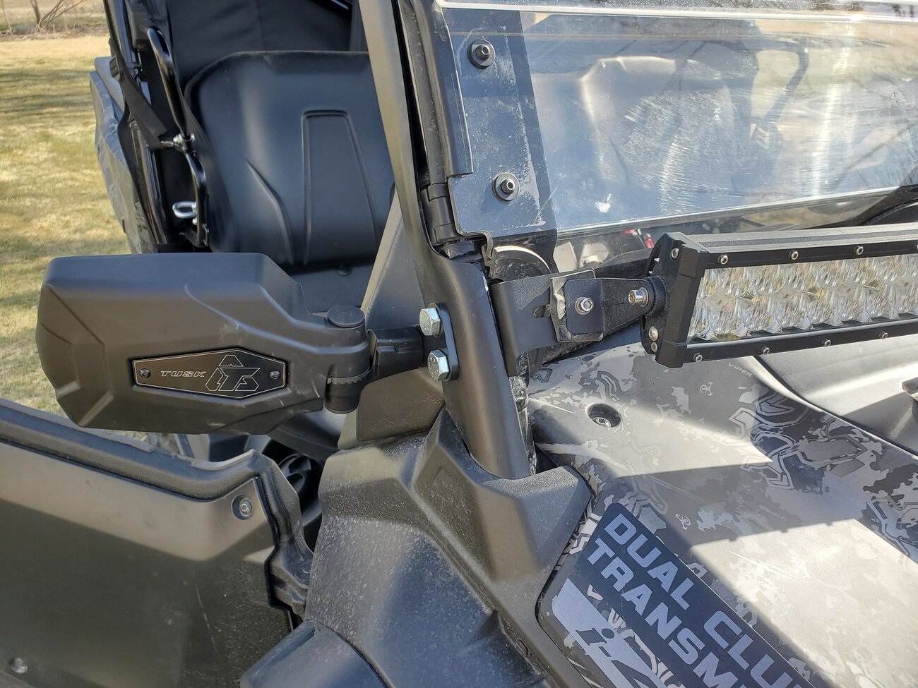

Mirrors <>Soft Side Windows Closed <> Vision is Poor At Best.
Think OUT of the BOX.
Locate the Mirrors <> FORWARD <> to be seen through the Windshield
Takes a little imagination & fabrication ( CLEAR Vision is worth the Effort )
Attached pictures show this Done on Pioneer 500 <> 2nd. <> 3rd. & 5th. Pictures are form Setting IN the Seat.
2 <>Different methods shown <>1st 3 pictures<> using Roll Cage bolts <> 4th. & 5th. pictuers using Winhield Clamp bolts.

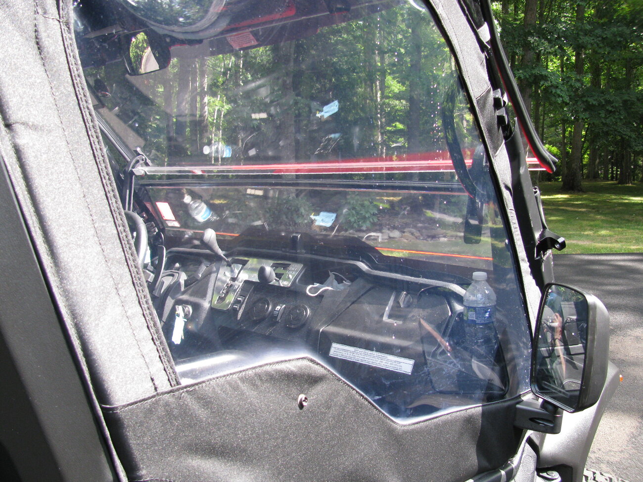

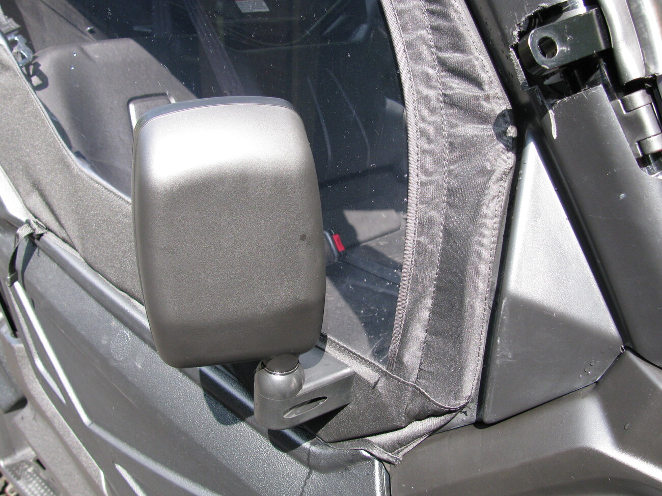

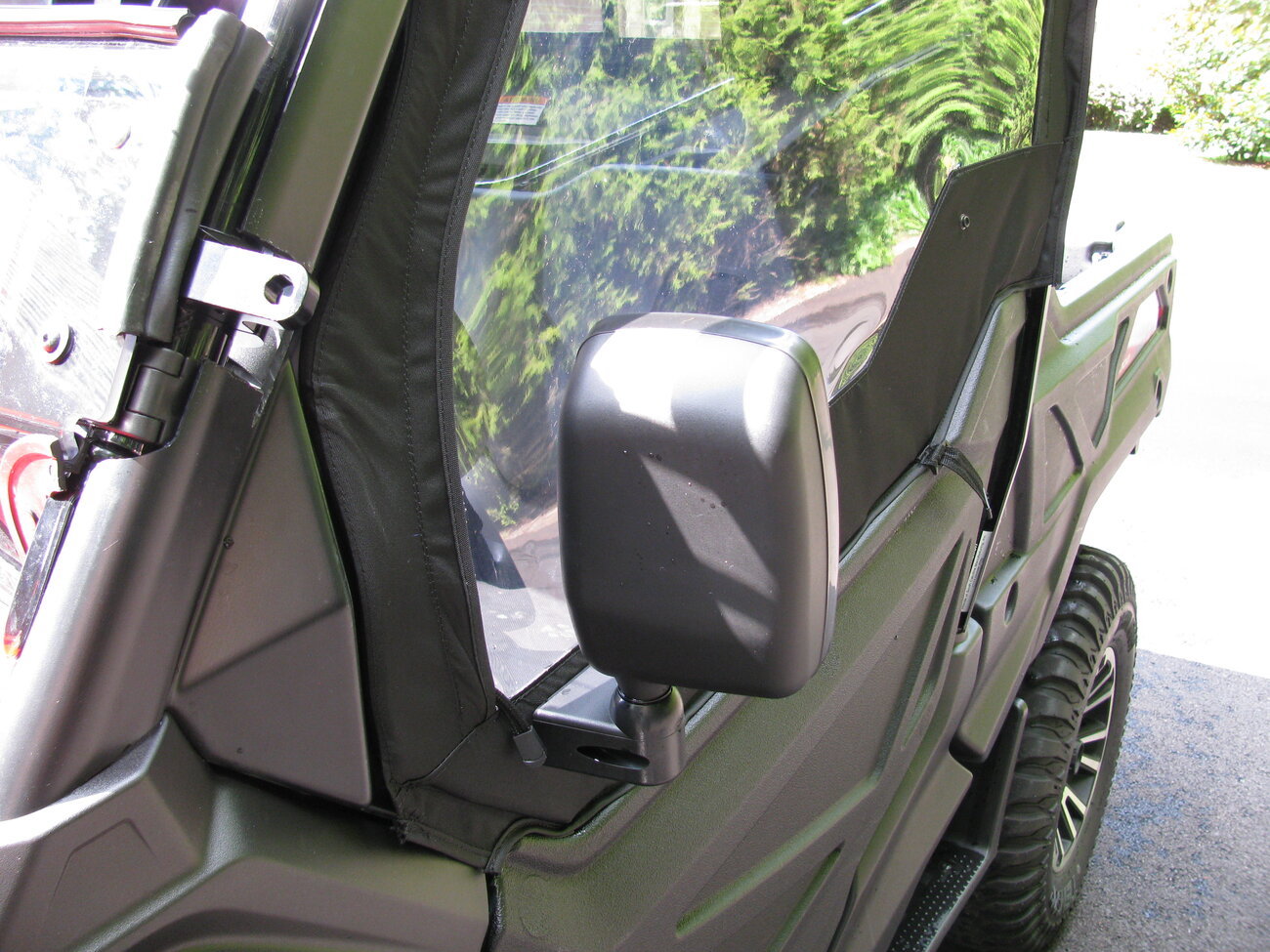

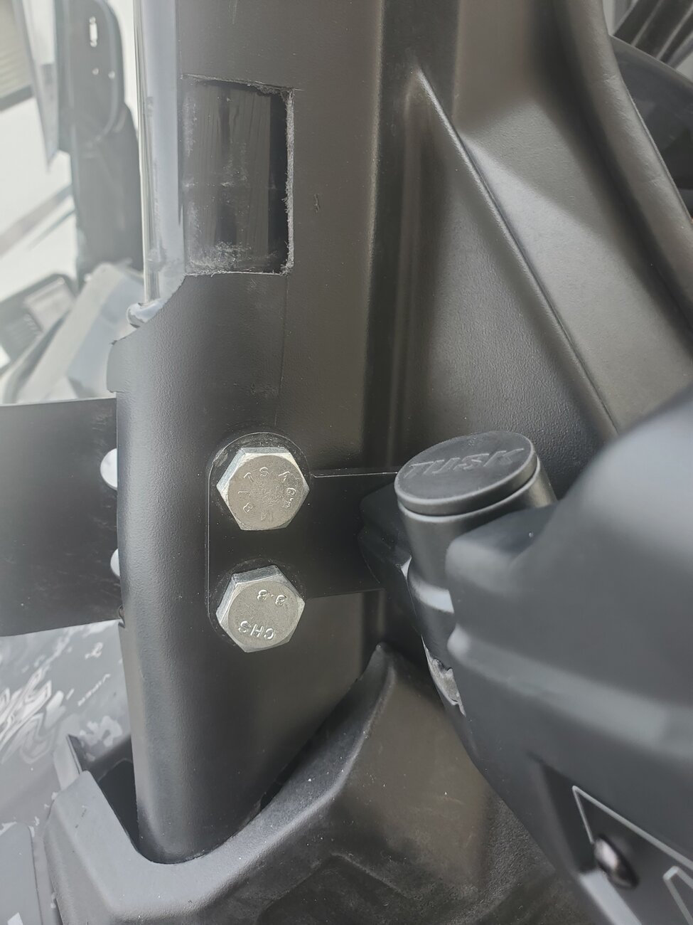

Hi. I really Like this option. Can you explain to me better how you installed these and which mirrors you purchased?
See post #20 in this thread: P1000 - Mirrors
In my opinion, the search feature in this website software is not the most intuitive or user friendly I've seen but it is functional. If you search the forum for variations of "Honda Mirrors", "Honda Mirrors on Honda Soft Doors", you'll find a hundred or more posts on this subject. I know of no magic routes to finding the ones discussing the solution I used other than slogging through all of them.
As I have explained in earlier posts, I did not design or fabricate the brackets. A highly skilled metal fabricator friend made them for himself and generously gave me a set. His design is not patented and he has given me permission to post photos of his simple, clever, and very functional design. The fabricator does not object to anyone copying his design.
I can tell you the brackets work great. Mother Honda should copy and sell his design with their mirrors. Mine are OEM quality. They are strong and durable. The brackets do not vibrate, shake, or allow the mirrors to move.

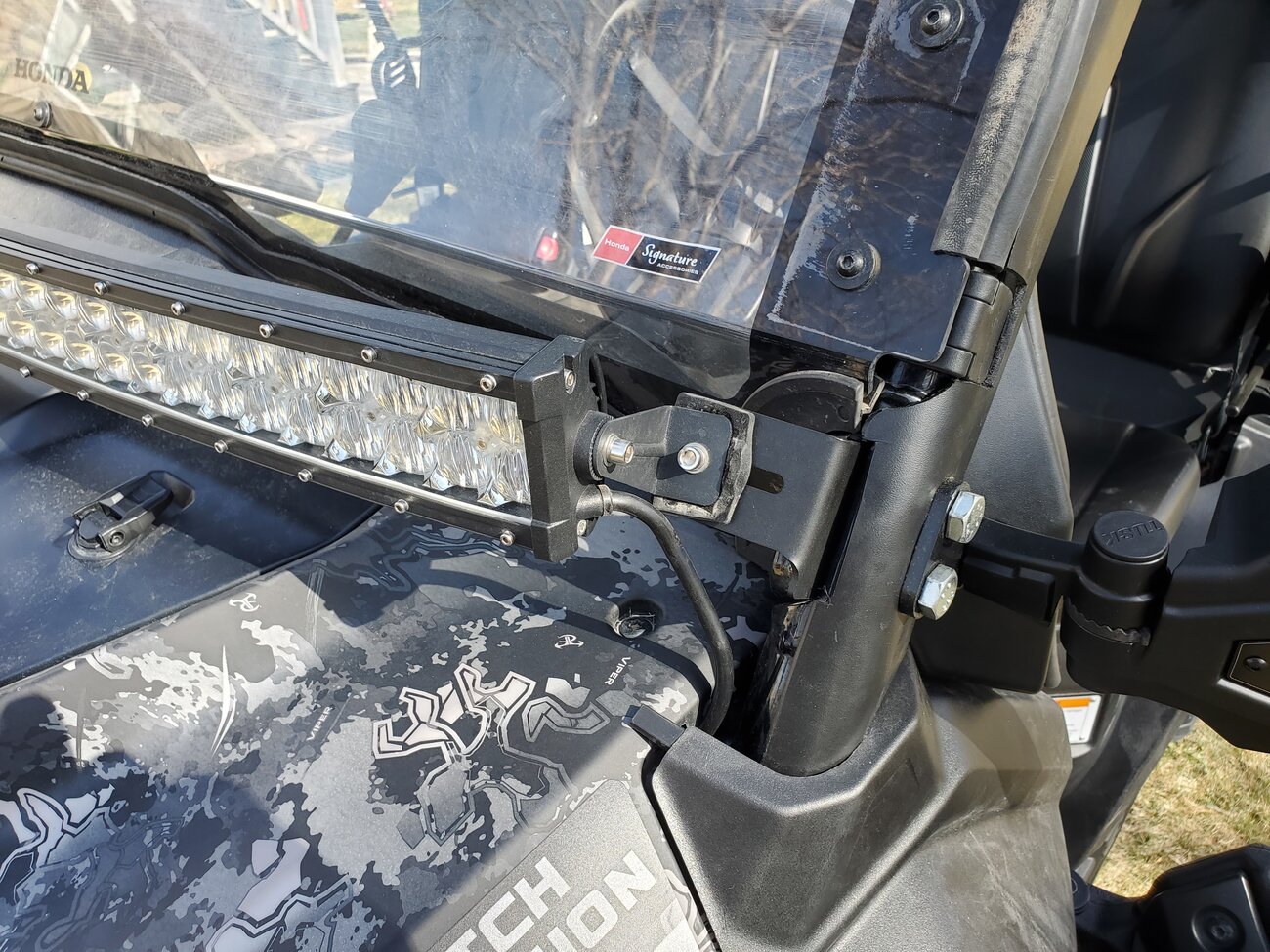

I designed a mirror/lightbar bracket for the Honda pioneer 1000 lineup. Its called the A-Pod HSD and is avaliable at ghost rocks off road.
