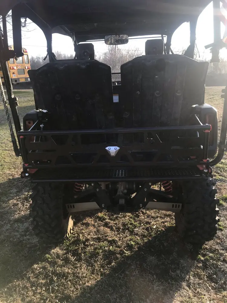

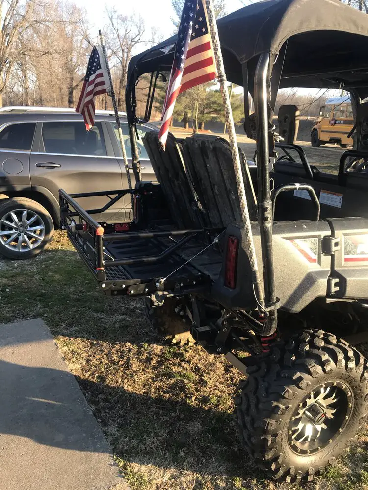

Finished upgrade
7DE7A47A 2DE2 4F72 A054 4D3077DE269D 3EAB5576 5C76 401C B746 994B6B4F1004 4C56E42D 10EF 4709 8DD4 4D0C6D9AE8FD
WagginTail
WagginTail
Oct 13, 2020
1,496
5,521
SC
Well....went with 2 1/2” highlifter lift.....14” system 3 st3 wheels and 28” system 3 xtr370s. Will post pics Monday
