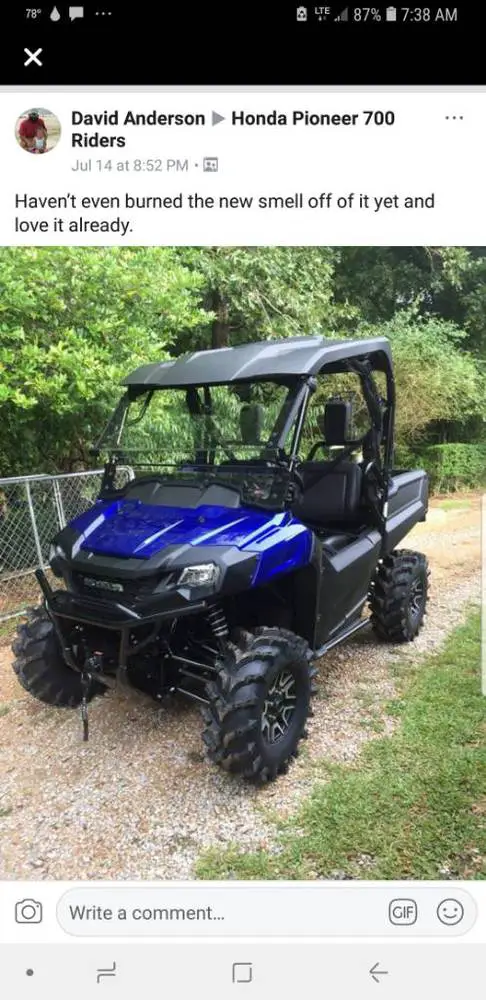

Tomorrow I am ordering 28x10x14 mudlites for all 4 corners. Did you end up going with 9"? Mudlites? Just curious if you were happy.
Wondering if you have had any issues with the 28x10's. Are the front and back rims on the same off set and any rubbing or steering problems? I am gonna try it with a 12 wheel soon.
Reactions: HuntKy
Dragon3
Jul 2, 2017
30
Long Beach, MS
I literally just ordered them about an hour ago! Ive read until my eyes are about to pop out and there are alot of different results. However, I have concluded that 28" wheels with aftermarket wheels with the 5+2 offset will not rub. Some are running 30's with that set up and are slightly rubbing and fixing that issue with a heat gun and slightly molding floor or using 1" to 2" shock spacers. With all that being said, my only personal experience is a friend bought a 700 a couple of weeks before me and he put 28" zillas on his stock wheels and he rubbed. He added wheel spacers to eliminate the problem. I fear that with stock 12" wheels and any tire 28" tall that is over 9" to 10" wide will rub. The 30" tires I spoke of earlier were 9" wide all the way around. I was so close to ordering those tires is wasn't funny but I got scared. I have a SuperAtv 2" lift new in the box but I dont plan on needing it. My new shoes will be here Friday so I will update you then

I am hoping the 27x10x12 swamp lite all the way around will do right. Let me know how yours go when you get them in please. I really wanted the tires where I can rotate front to back.
Dragon3
Jul 2, 2017
30
Long Beach, MS
I can almost guarantee you will not have any issues with those tires. That is my exact reason for same size all the way around. I think she would look better with the wider tire in the back but.... Rotating will extend life of tires alot. One of the local shops here was selling 700's with 28" swamplites stock

I am also looking at the 27x14 Outback Max. Seems to be a all around great tire. Just kinda heavy. Anybody run them/
Dragon3
Jul 2, 2017
30
Long Beach, MS
Theres a guy on fb site thats running them on his stock wheels and they look incredible!
Dragon3
Jul 2, 2017
30
Long Beach, MS
I didn't think they would fit on a stock wheel. Looks great! May be the direction I go.
I haven't looked at those tires specifically but just about every tire manufacturer offers a 27" tire for a 12" wheel.
