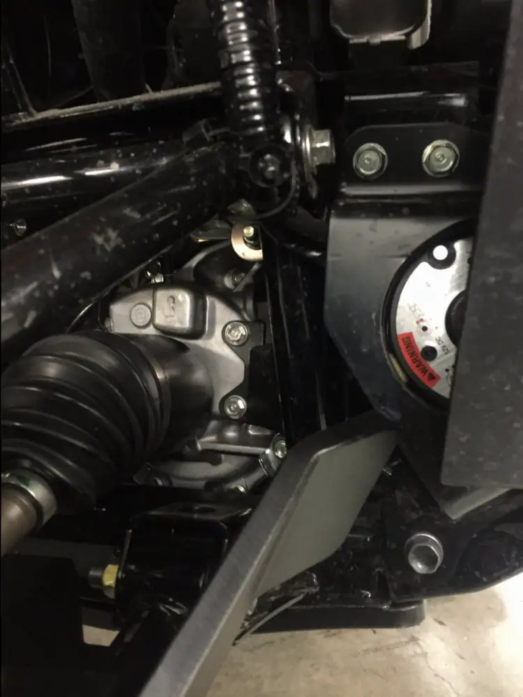

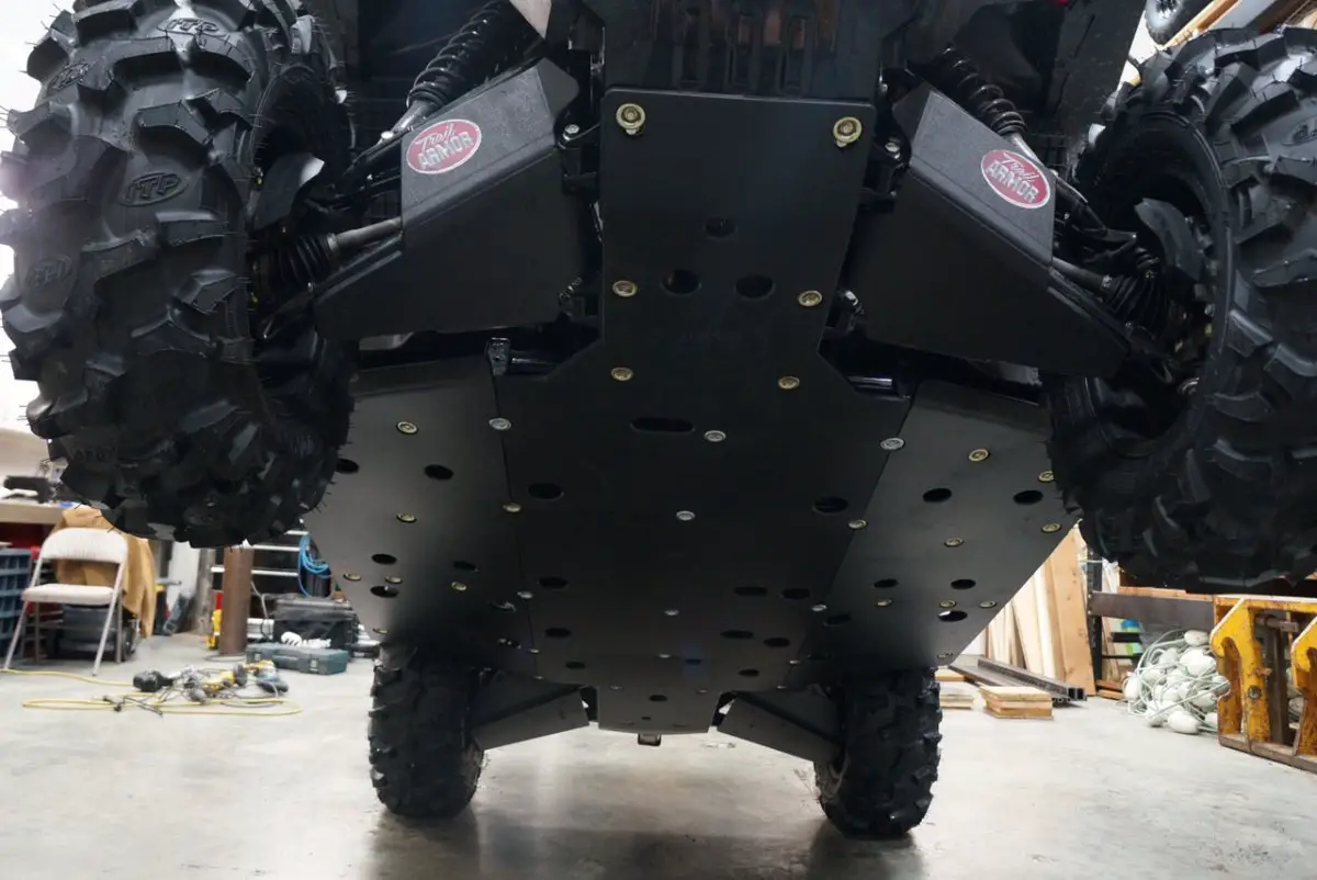

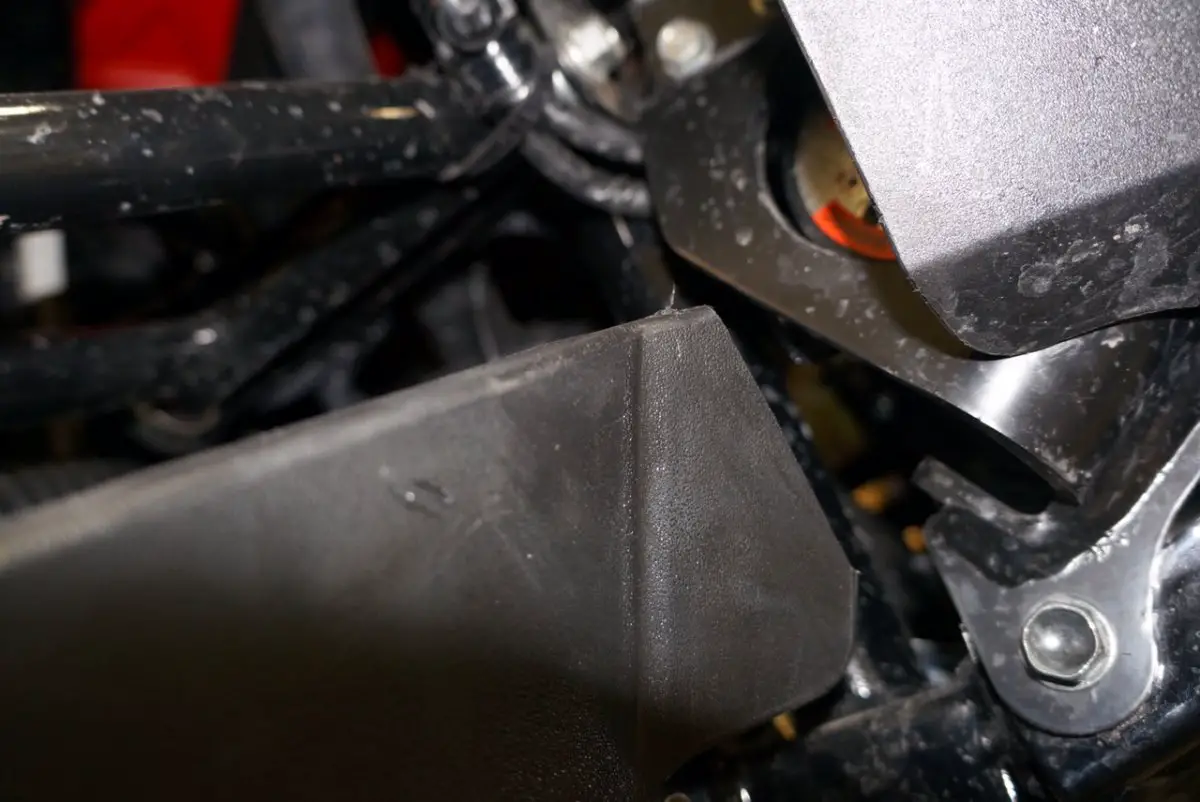

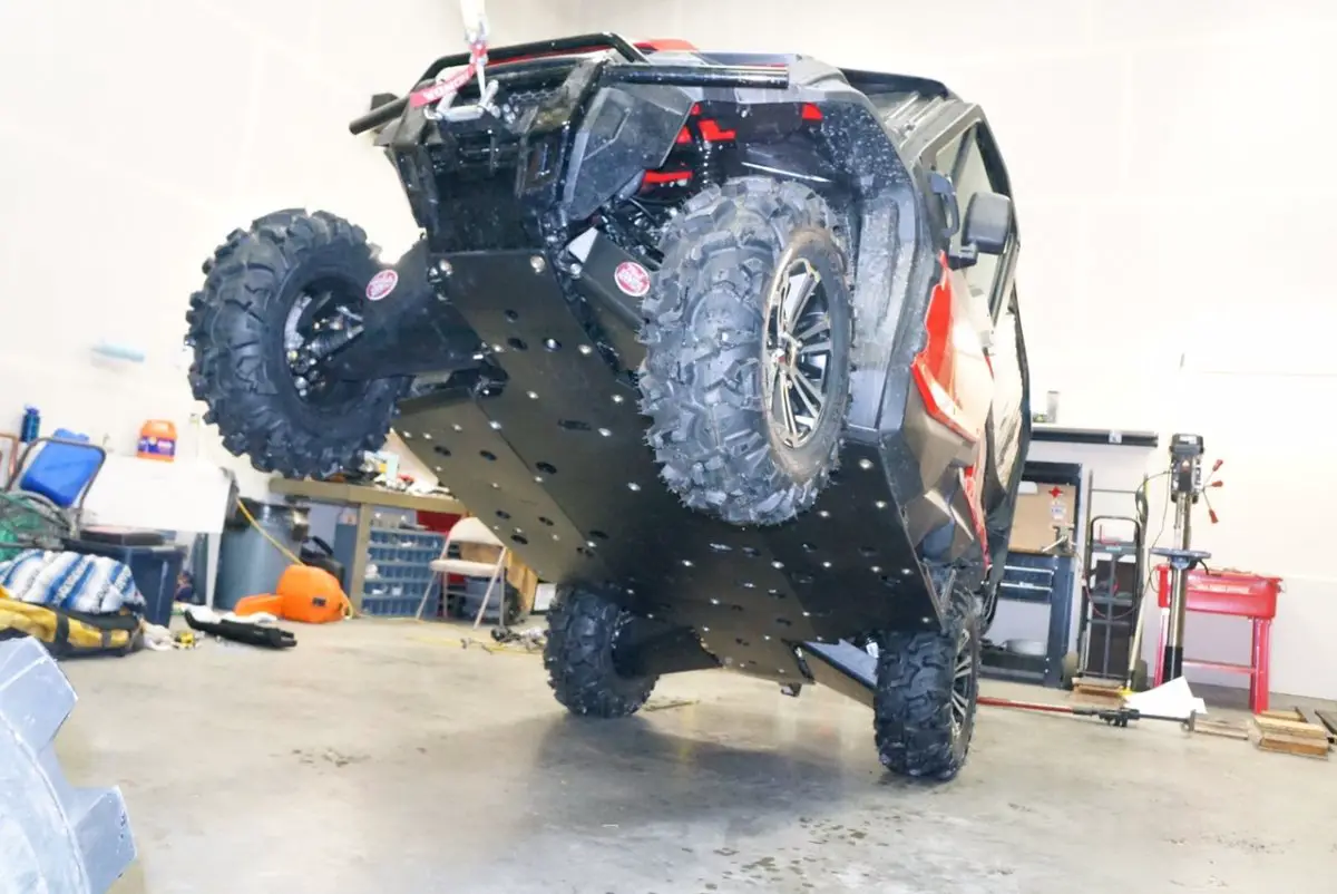

Installed the Trail Armor Skids and A-Arm guards this weekend. A-Arm guards straight forward although the backs are a bit tedious to put on, careful not to over tighten as the fasteners will pull through the UHMW material. For the skids, I used two ramps on one side, helped a bunch, not ideal but got it done. Make sure you have a strong cordless drill! There are 32 self drilling screws/washers that go in in addition to the OEM screws.
Nice! Mine arrived on Christmas Eve! Install went well. Drill got a work out. All holes lined up great. A-Arm guards went on pretty well, although I had to trim the corner off the front guards. I don't think Trailarmor's test machine had the winch mount installed on it yet. I tried to take a picture to show the interference with the winch mount. I trimmed the corner and it fits fine now. The rears A-arm guards looked pretty close to the wheel, but they cleared.
One downside I can see is the self tapping screws that come with the kit. That is probably the best way to do it (and I may just overbuild everything), but I would have liked to see a couple more bolt/nut supports. I didn't want to over-tighten the screws, and strip out the threads they created, so hopefully they hold up to the abuse they will see. I was concerned there wasn't much of a bash plate, but the stock metal plate up front seems fairly stout. I might have out local UHMW supplier build one.
IMG 1383 IMG 1419 IMG 1426 IMG 1427
View attachment 8390 View attachment 8391 View attachment 8392 View attachment 8393
Nice write up, I have not installed a winch mount yet either "still" waiting on KFI been 4 weeks now, will advise if I have any clearance issues when I go to install it with the front A-Arm guards. Very happy with how everything lined up on my set as well didn't try to force me to drill through any welds like the SSS offroad kit did on my P500
