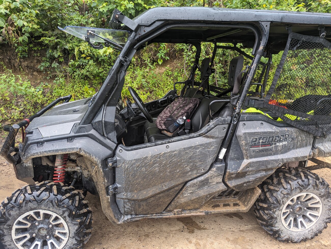

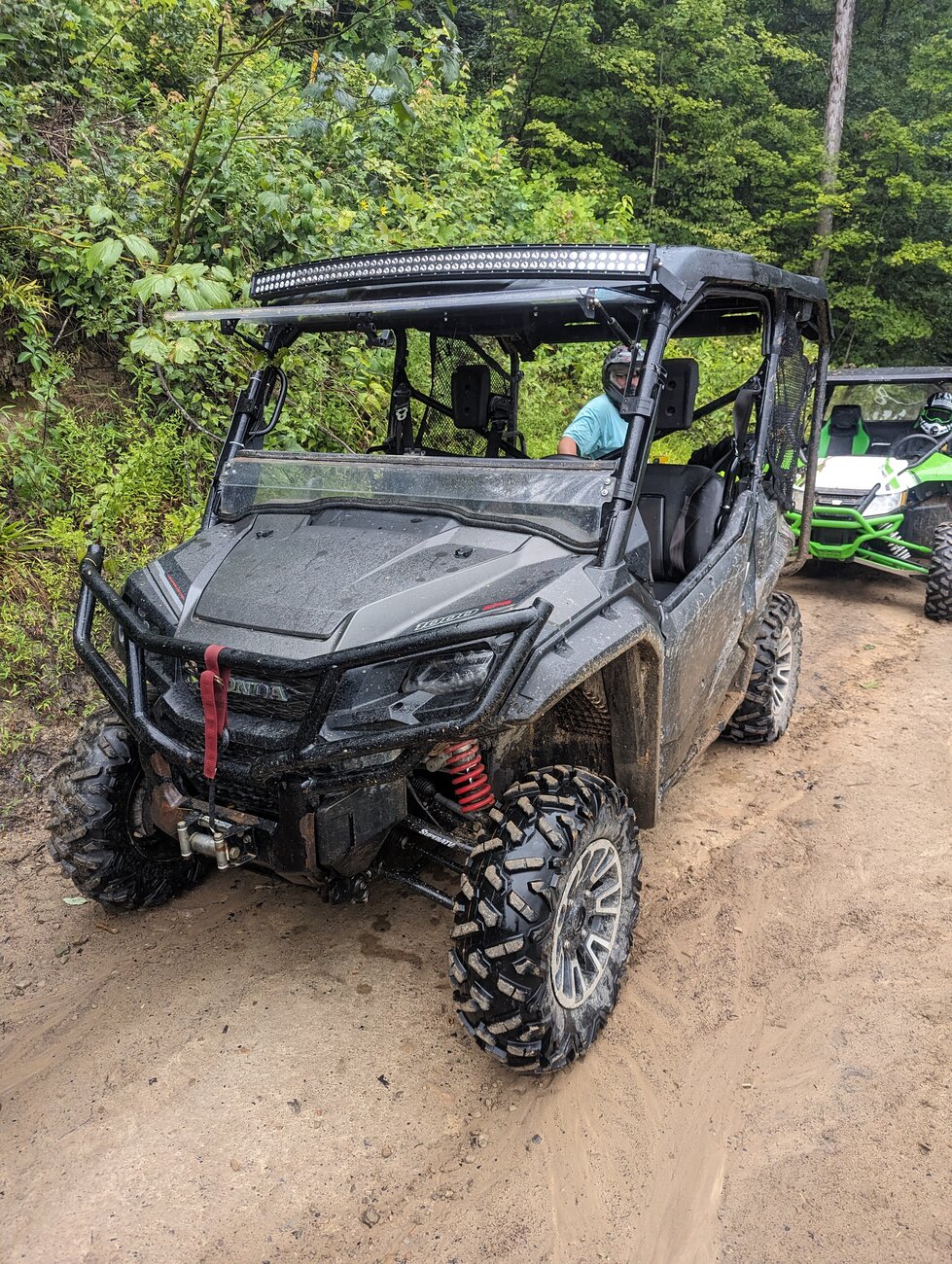

Thanks appreciate the guidance! Just drove from NJ to WV and tore apart Hatfield McCoy. Was an awesome trip!
PXL 20230803 131448550 PXL 20230803 131441080 PXL 20230803 131431206
