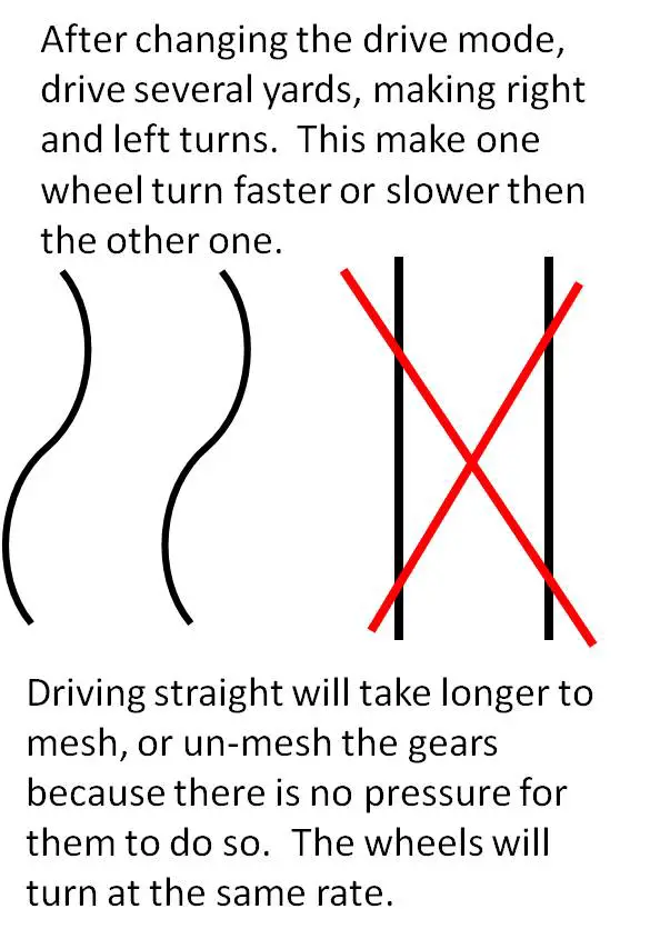

Adjusted mine as in video, worked great.
Something the book said, that I am wondering if some of you old hats are forgetting, but us new guys sure need to know.
"After changing the drive mode, drive several yards, making right and left turns"
When up in the air, you are the one doing the turn right, turn left, by only moving one wheel. So, the gear switching is quick, and no pressure on the system at all.
I have not had the rear end apart, but it doesn't really matter, gears are gears, are gears.
You make them mesh, and they like to stay that way, until you pull them apart, or they push themselves apart. Looking at the system, the only spring I see is inside the adjuster box. That little spring has to move them gears. Granted, probably pretty small gears. I work on 18 wheelers, so big difference.
So, for us new guys, here is a picture to help.
I should have read my manual by now. Thanks for posting this. I tested out this theory and as I turn the wheel it will engage/ disengage immediately.
