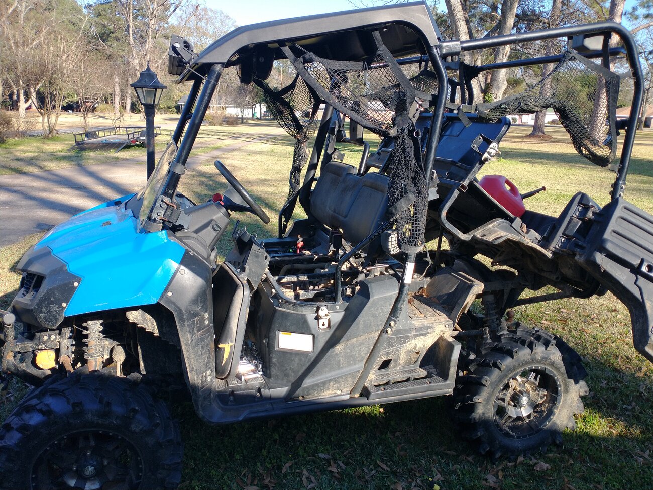

so i have a little bit of an update. i was reeding on one of these forums and someone said they were having an issue with startup, they had to put the bike in gear and press the brake for it to crank. I have been trying to get this thing to start in neutral and it wouldnt. So i put it in gear and pressed the brake and it cranked first hit. Seems to idle fine but still have the same low throttle runs fine heavy dies out. I havent checked the air filter yet, but it was brand new before just before started having these problems. put a little to much silicone on the lid when i was water proofing everything. Just wanted to see if the consensuses was still needs a rebuild or possibly something different to try. thanks for the help
I would recommend a compression test before tearing into the engine. I am a bit concerned about your original post of letting the machine sit for a week before flushing and drying it out, but I would still do a compression check. Are you getting any flashing codes on the display? If compression is good other thoughts would be a coil to the plug you say is black and dirty, check all the coil connections and make sure they are not connected. If the two cylinders have separate coils maybe swap them and see if the dirty plug problem moves to the other cylinder (not sure if you have separate coils, and if so if they are the same. My P500 is a single cylinder so I can't check for you).

well put the compression gauge on this morning guess i should have done that to start with. only 60 on the gauge so looks like top end rebuild here i come. iv been looking and cant find a full engine rebuild kit just the top end. anyone got a website

I can’t believe it even starts with only 60 lbs. of compression.Did you leave one plug in while you tested the other? I could be wrong but I believe you still have water in the ol girl. When you sink them on a warm day the tank contracts and literally sucks gallons back in as the cold water cools the tank down.The front and rear diffs will do this as well.Just my oppinion.

Ya i was a little surprised at the 60 lbs my self. i checked it from both plugs with the other installed. Im just going to pull the motor and rebuild it cause i know it needs clutches too. im still trying to figure out the starting with it in gear and the break on, but not in neutral. any ideas on that.
