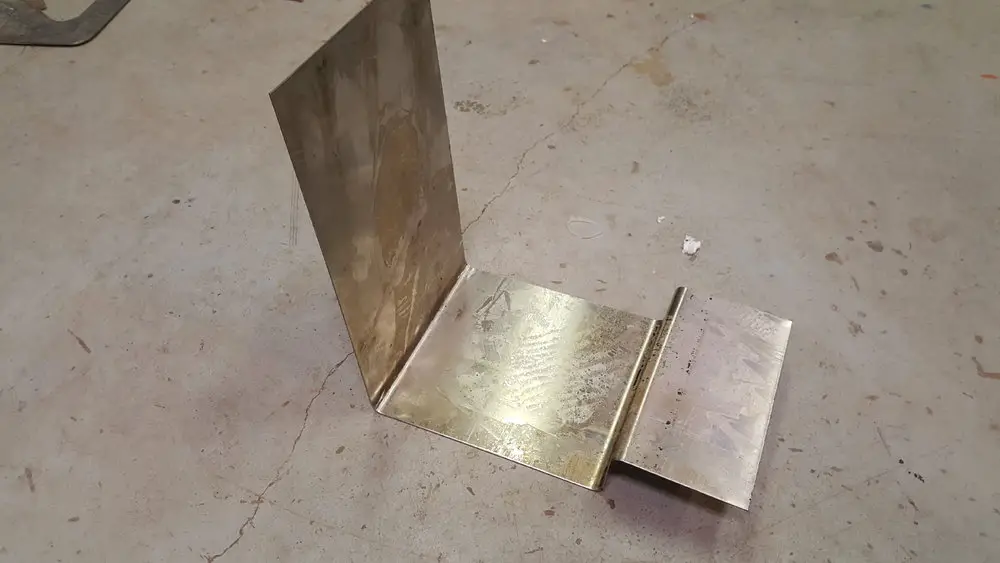

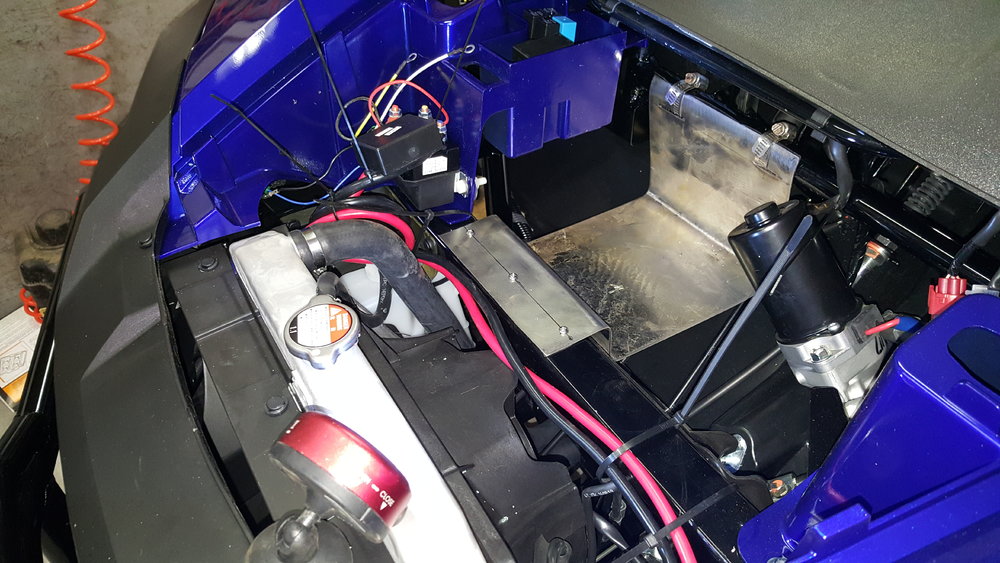

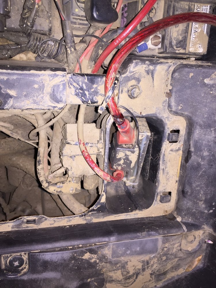

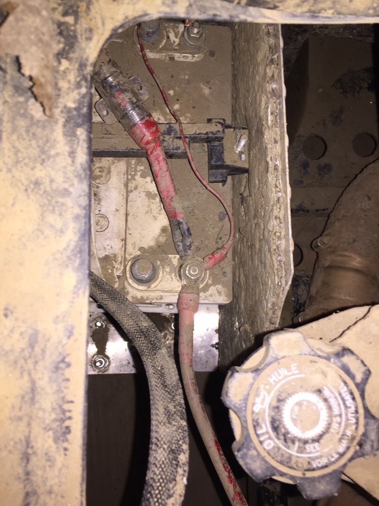

Just got my new 700 deluxe. Installed a viper 4500 LB. winch and with that kind of load needed to install an extra battery. There is not an easy place to install an extra battery. If you install the battery under the drivers seat a much more complicated battery box would be required (why Honda does not have something there from the factory is beyond me!). I chose under the hood for the spare battery. The attached photos show the installation. After measuring the area I wanted to use the largest battery I could install. I installed a 30AH battery that I found at a Batteries Plus store. Installed a True battery isolator. All wired to the original battery to allow for charging. Grounding is through the frame. The battery tray is fabricated from 14 gauge SS. The back side is held in place cutting 2 slots in the SS and using hose clamps on the round frame member. Drill and tap the square tubing in front. Battery isolator mounted using double back adhesive foam tape. Battery hold down is an off the shelf rubber strap with a nylon spacer block to anchor the battery.

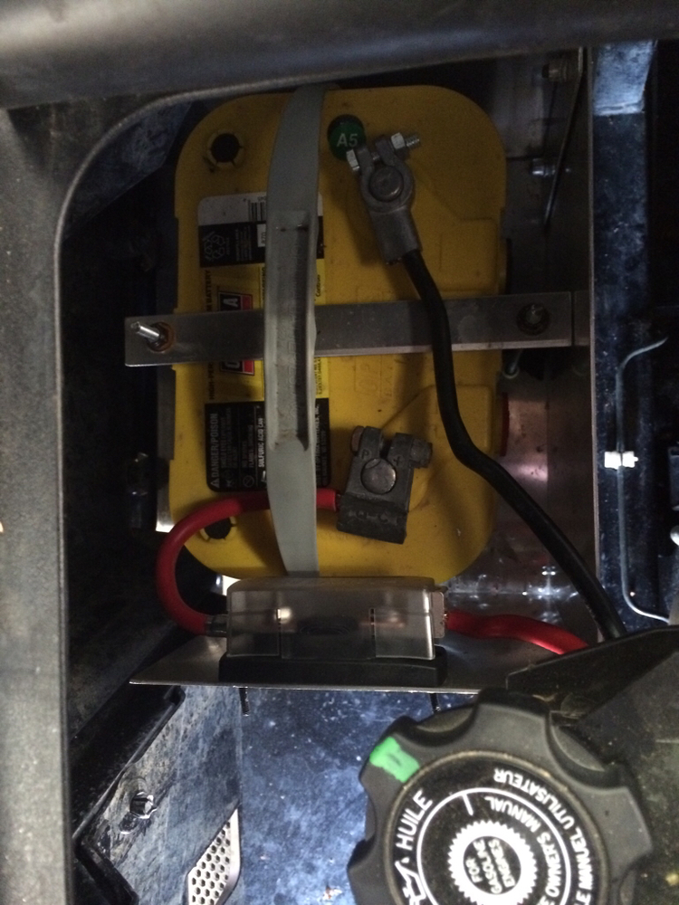

I would not consider the install complex. I made all the tray parts myself and installed in less than 2 hours wiring and all! As someone else posted they may want to install under the drivers seat but this will require a much more detailed installation to make it water proof.

Just mounted mine under the seat like most people. Just a bottom and side for heat protection. Put some cell insulation on the inside.

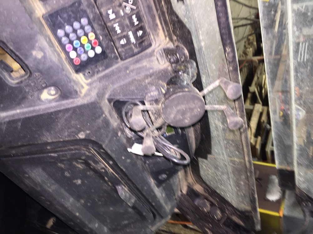

Used a True isolator. Also got a knockoff RAM mount off amazon to mount my phone.
2ndbattery Isolator Phonemount

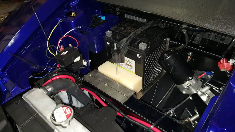

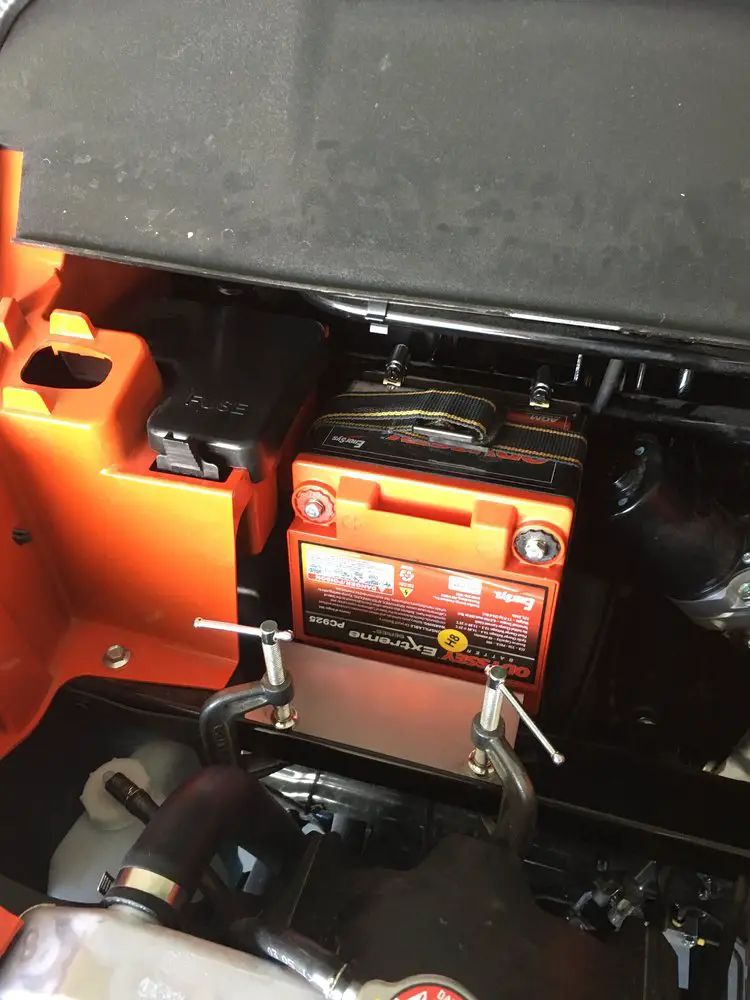

Hey RockRiver...I looked and looked and looked for the best way to mount a second battery, and really wanted to put it under the hood. Your idea made really good sense and seemed relatively simple. I designed mine to fit the Odyssey PC925. The mount is 6 inch wide, 22 ga steel, that is 17 inches long bent similar to what you did. The photo is a prototype, I'm gonna redo with fresh crisp bends and right size clamps (that is, the hose clamps on back--c-clamps are temporary until its done--and I'll tap some holes on the front to secure it there) but even this temporary install is incredible stable with just a strap. I made mine to have the battery lean back against the back too; which seemed to help secure it and will pad the back some with closed cell foam when final. If you have any insight having used your's for a year, would appreciate feedback--but again this seems like a really nice and simple alternative to under the driver's seat with easier access. Thank you for sharing your good idea!! (plus for the 2018 model, color matches with the Odyssey battery!)

Looks very nice! Mine withstood several hard rides on Wisconsin trails and came thru with flying colors.

Great. Thanks. Decided to up mount to 16 gauge for a bit more strength. Anyone know of a good ground location under the hood or nearby up front?
