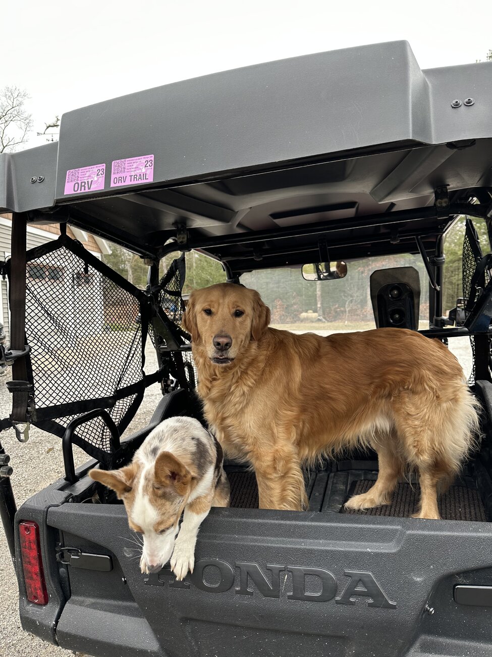

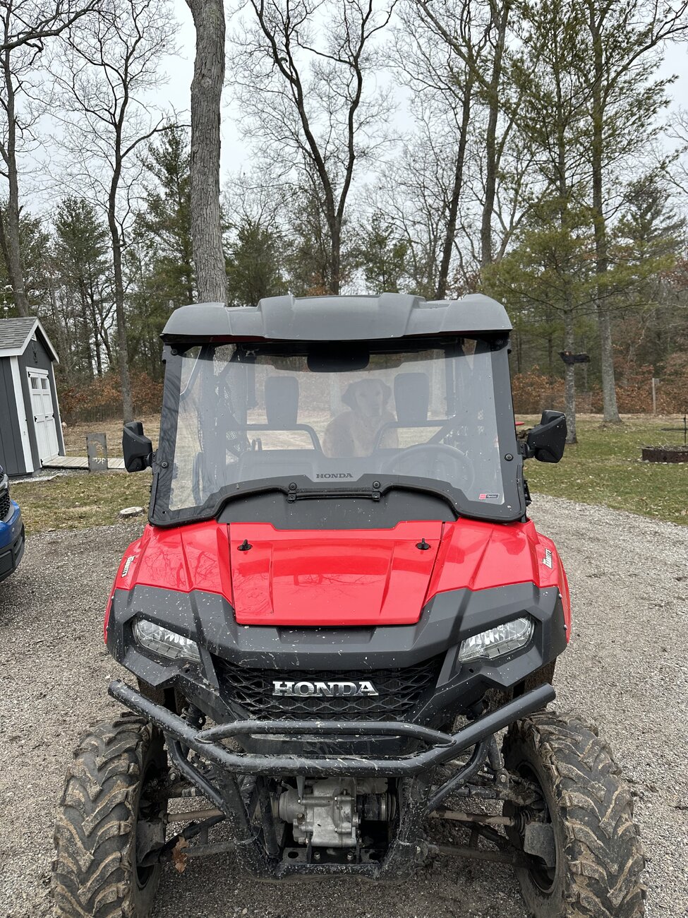

When u first join/post must provide pics of the rig! Its Rule#4
Pics Or It Didnt Happen!😉

IMG 2356
IMG 2354
IMG 2354
