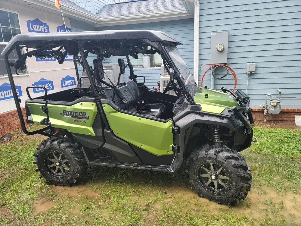

Hey all. I bought a 2020 Pioneer 1000-5 Limited Edition last year. I have been looking to put a lift kit on it to clear some bigger tires. Everywhere I look says that the lift kit will not work on the Limited edition. What makes the Limited edition so different from all of the others and does anybody know where the best place to find upgrades for it? Thanks in advance.

and.....PICS OR IT DIDNT HAPPEN!
So i wouldnt bother with a lift. You supposedly have an LE so you have fox shocks. Adjust the preload if the shocks to get your lift, then the geometry of the machine will not change.

I have found some offset a arms, mostly 1.5 inch. From what I have read, I could go with a bigger tire then. The only thing I have found really as far as lift would be portals but I'm not a big fan of them. They just don't look very sturdy to me. I may be wrong on that assumption but the machine is pretty narrow and I know I would be making it even more top heavy. I don't really want a gear reduction.

You can get a few inches with just your shocks preload set. The fwd a-arms will allow for 30” tires and give more lift. Don’t get portals, they are not great for geometry and handling unless you just go in the mud.
I only have Fox shocks and the SATV a-arms plus 30’s, I’m at around 17“ of clearance below the center of the skid plat.

Dont over think it! Preload it, get some wheel spacers, then maybe some arms later and your good!
Still waiting on them pics🤨🤟😜
