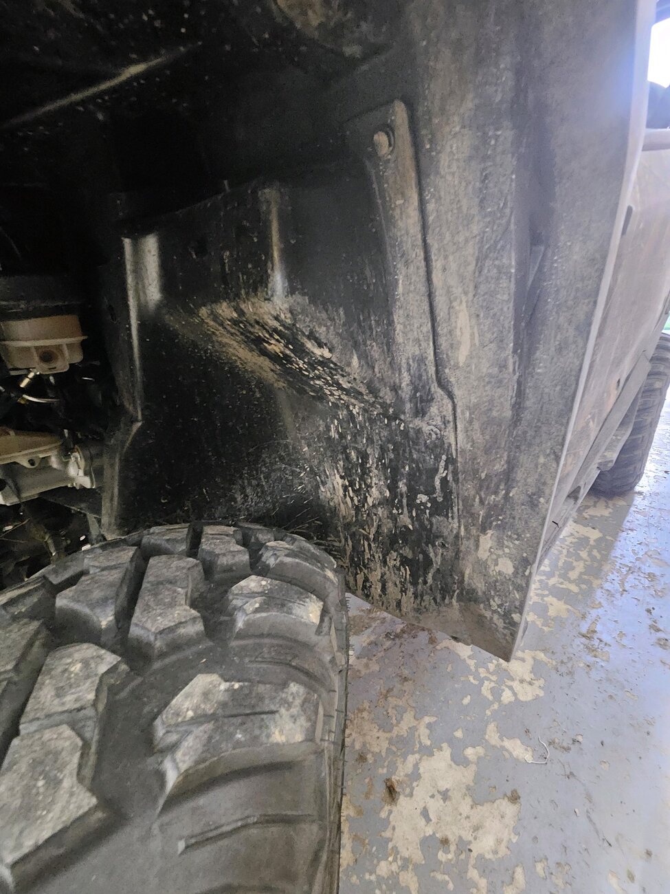

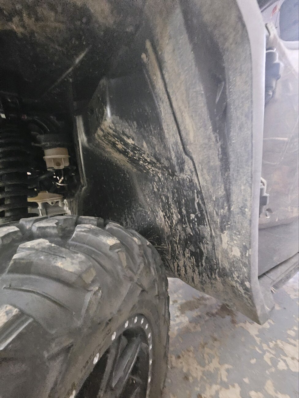

I’m thinking the satv ones don’t protect the place where your likely to wedge a stick like I did. There are some good examples on here on fabbing 3 or 4 pieces. I’ve got a retired buddy that’s good at heating and bending the heavy plastic. I’m going to replace floor, put on satv skid plate, then homade fender wall guards. I’ll send pics when done. In the meantime if anyone else has good fender well guard pictures or examples not already on the sight please post them. Thank you.

You could add the 22+ fender liners. They are fairly strong plastic that are smooth and covers the nooks and crannies that can catch the end of a stick and deflect it

I like that option, thanks . I found them pretty cheap. Have a buddy with a 22 sending me pics tonight. May still add a few pieces in the round part of the well. The new floor piece should be here Thursday.

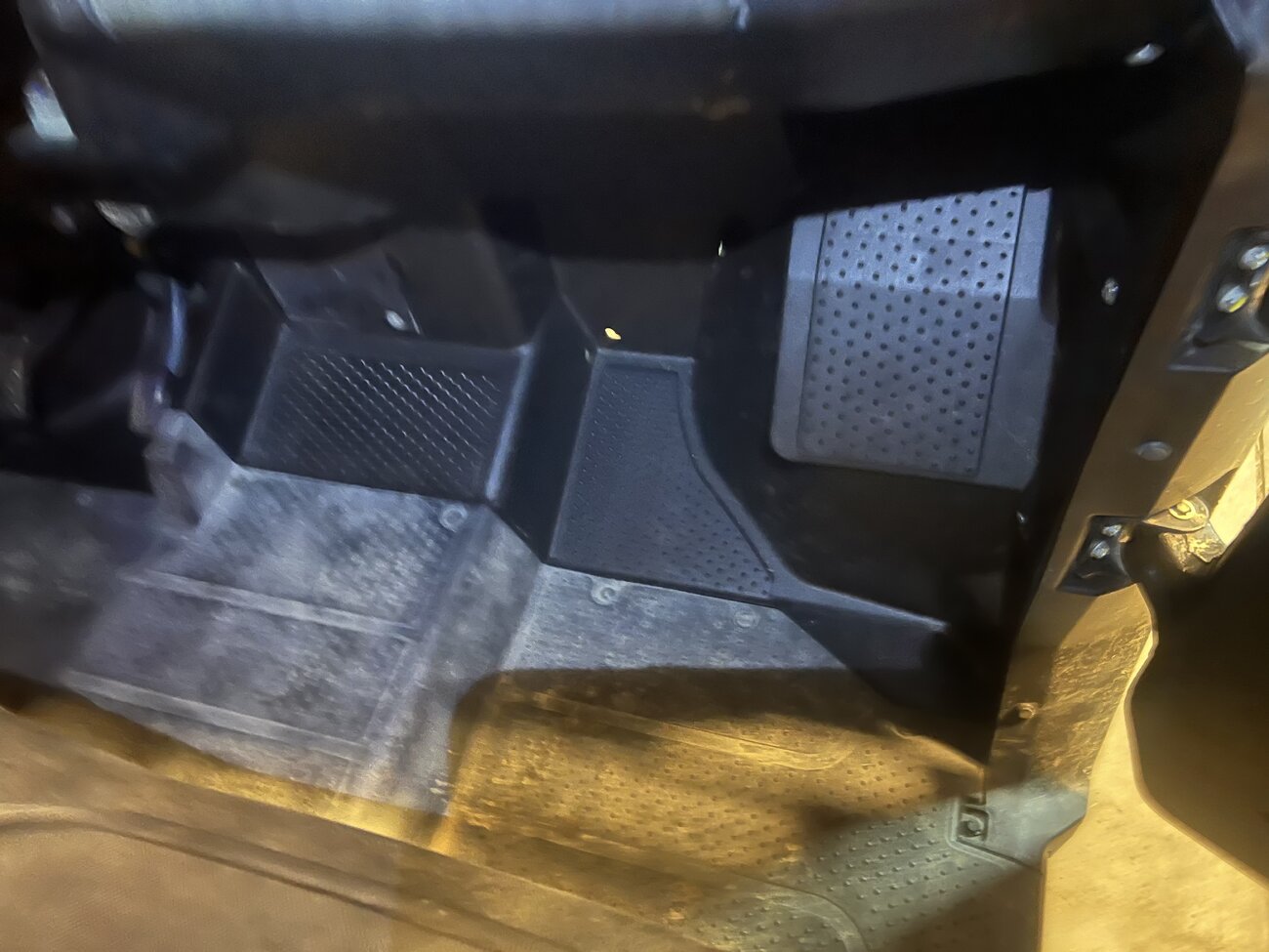

Phase 1 complete take your time need a 5mm allen, 10mm socket, tool to pull clips Don’t forget there is one clip on each side of fender we’ll on outside. Took a couple hours. You have to take the floor out to get this piece out. I watched a video on YouTube and he basically just said the things I typed. I found the part for like 130 but they were out of stock. Ended up paying 190ish from Motorsport. Shipped quick.

Notice the new piece already has the holes for the addon inner fender liner that comes stock on 22 and above. I have those ordered.
