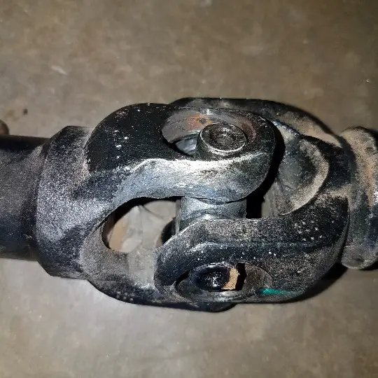

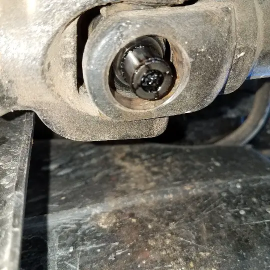

We had a 2021 Talon lose a bearing cap in less than 500 miles. Another friend had the front U-joint lose a bearing cap. If the bearing cap doesn't have a slight press fit, it will turn and push out the retainer C-clip allowing the bearing cap to fall out. I caught one at low speed before it damaged the yoke. I put it back in by hand and had it spot welded. My dealer allowed me to get my replacement drive shaft spot welded before installation. In my opinion the U-joint drive shaft won't last nearly as long as your heavy-duty CV drive shaft. I drove 3 miles at low speed to get back to camp with one.
This is exactly the reason I posted about the SATV replacement, I could replace the U-joints in my current one but if there's a better option I'm going to give it a try
