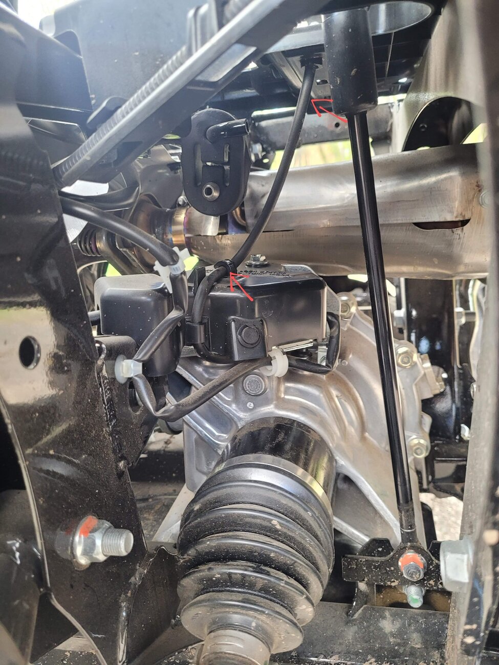

I can't locate the differential vents tubes on a 2021 1000. I ordered a shop manual in January and still haven't got it yet. I've watched the videos where the vent tube is located and mine does not have a vent tube in that location and I can't see one anywhere, front or rear. Are sealed units in 2021? Any know?

No, not different, not completely sealed.
Find the tube and follow it up.
Rear is on the driver side of the diff right above the CV axle infront of the sensor.
I'll check it out. But the front is not located right above the fill cap and there is nothing there on mine.

This is a 2022 image. A little different but here is the vent tube.
2022 also does not have shift box vent tube. But it does have front and rear diff, fuel, sub tranny and radiator fan.
So, your 2021 does too.
