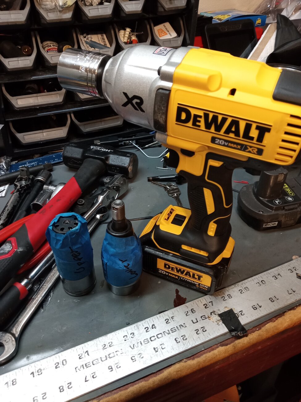

Got this new toy. Takes about 2 seconds to remove anything. 1200 ft-lbs . Again the 22 pioneer 1000 uses a 1-1/4" axle nut not 30mm.
Best of luck !
Rudy

Reactions: Robobrainiac
