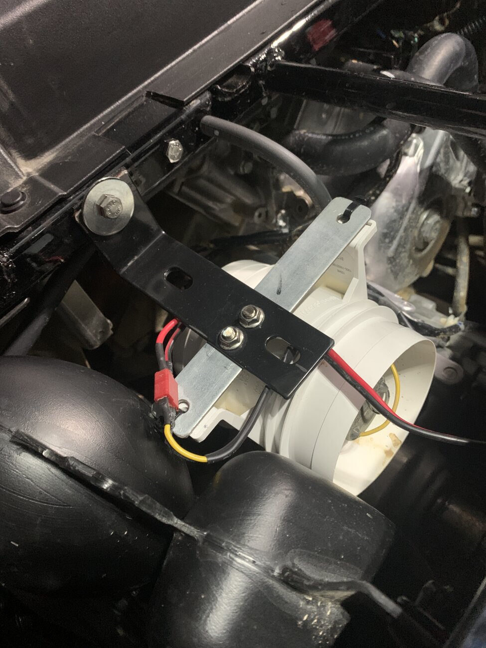

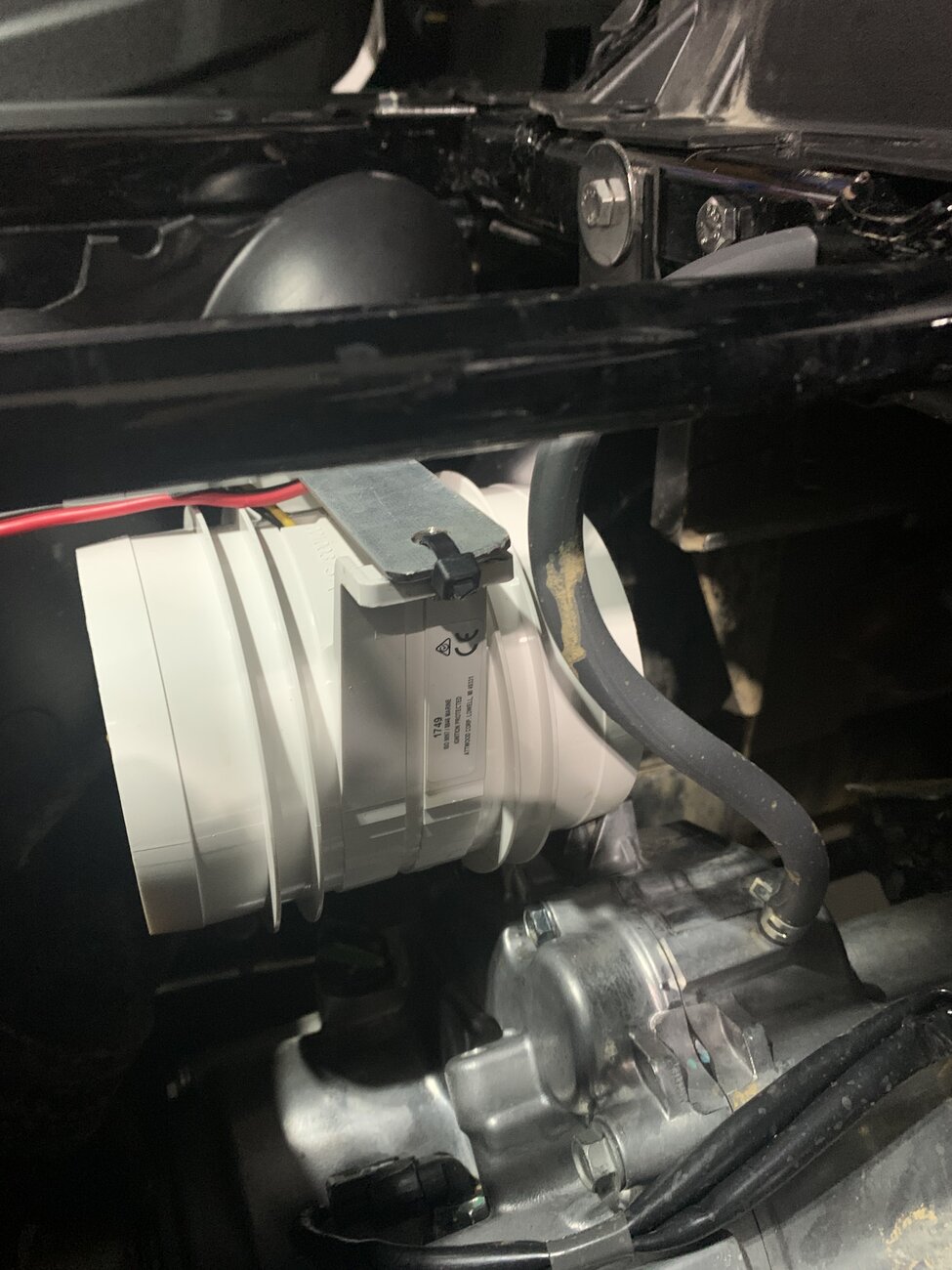

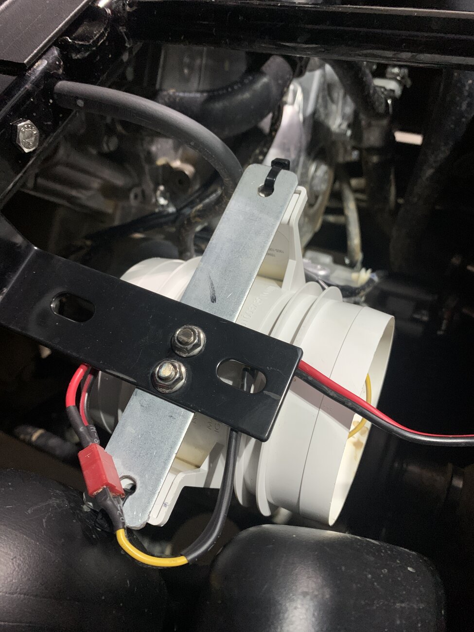

Right at front of that header pipe. I’m blowing air towards the header pipe. Should I be pulling heat away from header pipe and towards front of floorboard?

I have mine in the same spot but at a little bit of an angle so it pushes the hot air out of the rear passenger side wheel well. I'm not sure how much space you may have with that tray think now though. Worth a try 👍

How many CFM is your underseat fan? I had my fan on most of the weekend and never had an issue with heat. My Spal fan puts out about 300cfm which is likely more than your bilge fan but it is nearly in the same location. Only big differences are I have a tuner, radiator fan override switch, ceramic coated header and some insulation under the seat mid panel

Like @JenElio aka Jennay said. Need to angle it. Plus what @ToddACimer said, your CFM is too low. Should be able to run that baby all day and keep that seat cool. The @trigger shield will help also. Ive kept very cool with my fan since 16’ But it moves big time air.
