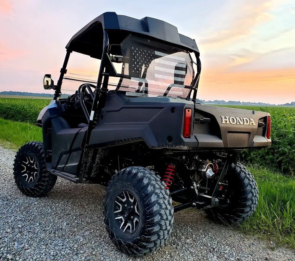

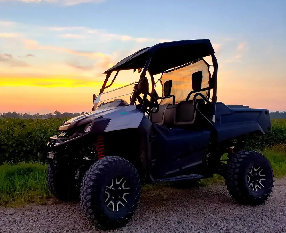

27's on factory deluxe rims here as well. No power loss that I can tell. Picked up a couple inches in height and much quieter on asphalt

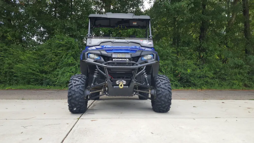

Awesome, thanks for the quick reply. If you could change to 28s would you? I can’t decide if I want to keep stock height and get 27s or get the Super ATV 2” spacer lift and get 28s so I can get a little more clearance. I’m trying to compare the pros and cons of each.
PS, is that a JBL speaker strapped to the frame bar in the top of the cab?
No I would not because know a couple of people with them and it changed the gearing enough plus with tire weight they have a noticeable loss.. with 27s you don't notice a loss .but they still do pretty good with 28s

I like it , they look much better with 27s and you will like the extra clearance . And in response to a question you asked a while back that is a JBL speaker on my cage.
