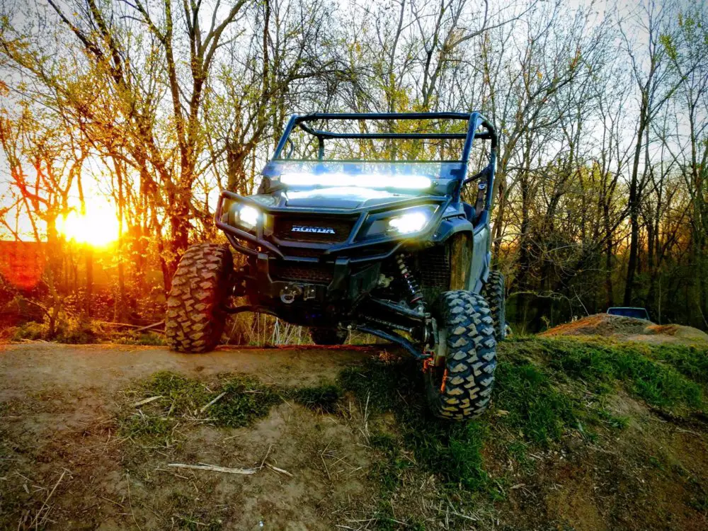

  2. Talon X LV
Is that what you are talking about. ;)
