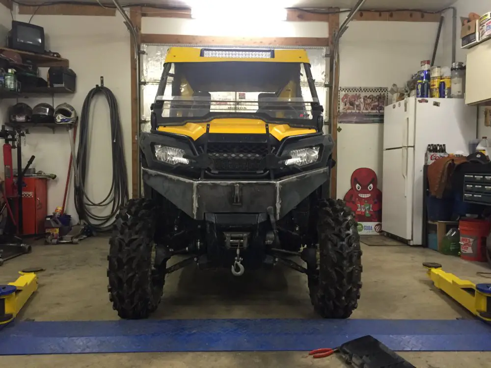

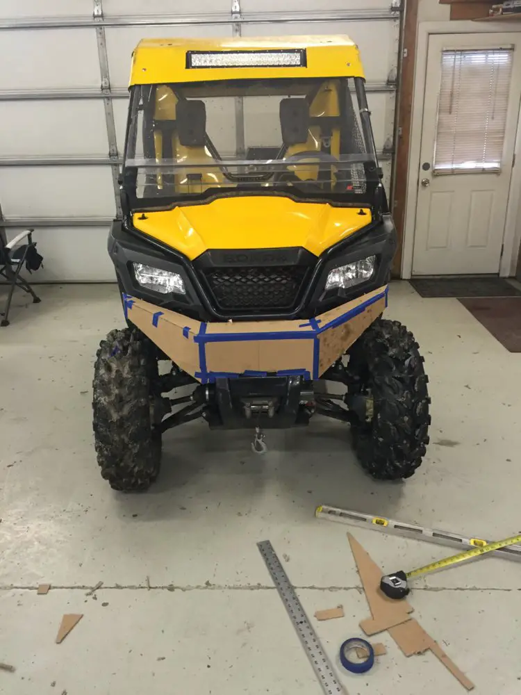

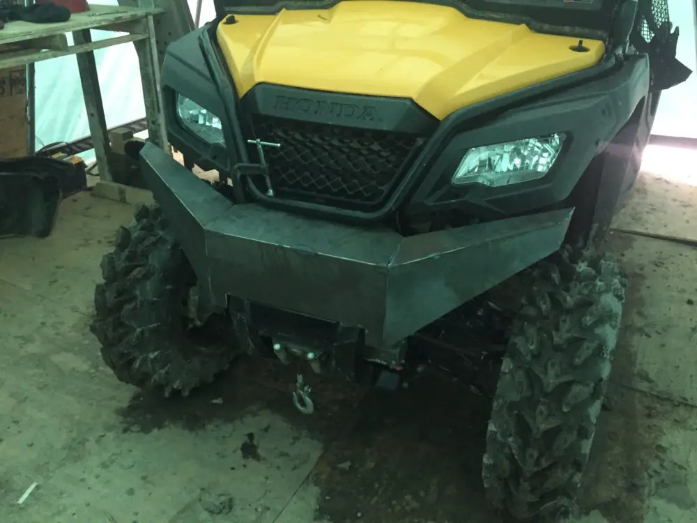

So after looking online I couldn't see spending hundreds of dollars on a bumper that in my mind doesn't seam like it's made with quality, I guess we could say. So $20 on steal $10 on spray bed linner and a day in the shop and I'm happy with my "Miller Made" haha what u guys think

Looks good! Like the front shackle point.
Thank you I won't pull off it my winch hook fits perfect just to keep it up outta the mud and water nothing worse than trying to find the hook when ur stuck haha

Really nice work!!!

That looks really good! Now I want to build one! What gauge metal did you use?

1/8 but I beefed it up and it's more than strong enufe hardest part was cutting the plate with cut of wheel and grinding everything to a tight fit

That's awesome dude, nothing better than custom!!!!

1/8" will be plenty strong, that's about 10 gauge. How heavy is it?

Where I got the flat stock they sell by whight and it was 41 lbs the amount I didn't use my guess is about 30 35lbs but I'll check before I bolt it on

Of course you're going to test it by rolling your buggy down a hill like that other guy, no?:eek:

Haha I hope I don't flip it I haven't yet. I could of used it lastnight tho good thing the plastic didn't break
