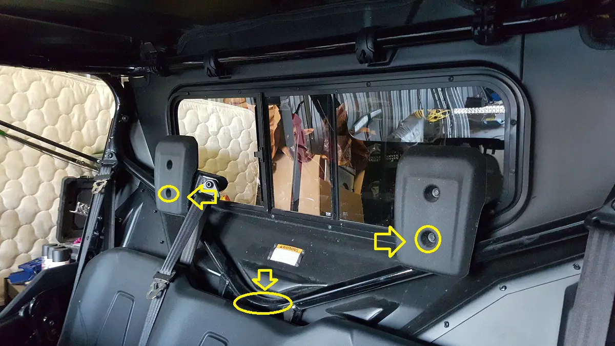

You are thinking wrong you mount both of the top ends of the 4 point restraints through the bolt of the black plastic headrest, the tubing has nothing to do with it. See the below picture to mount three 4 point restraints in the front seat.
Headrest

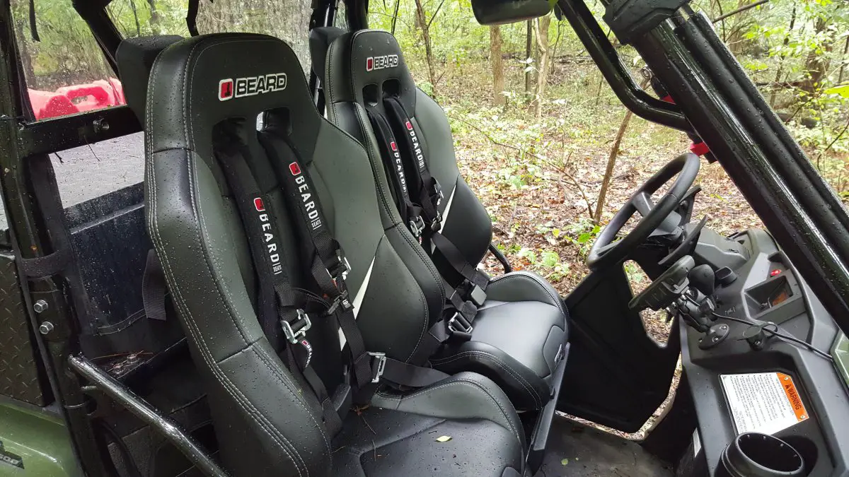

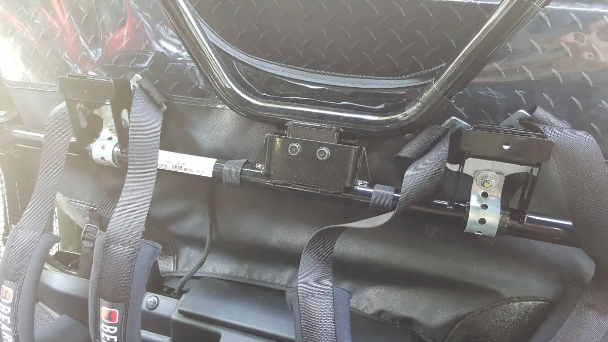

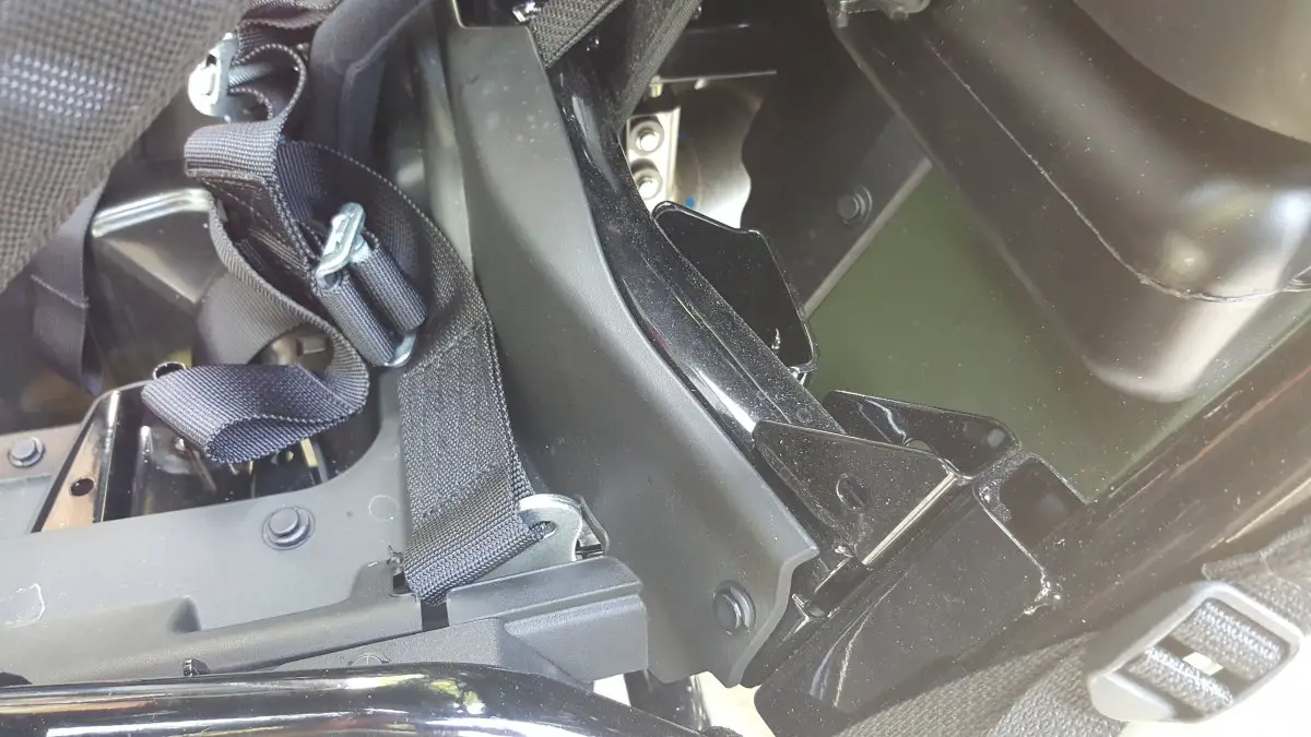

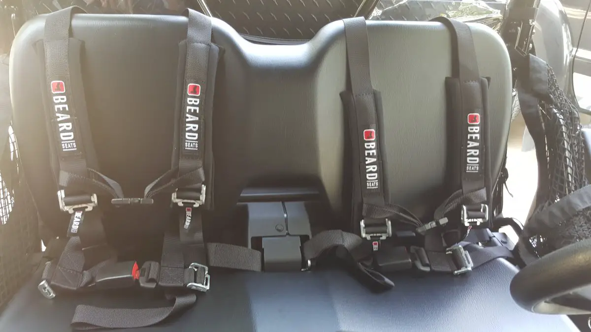

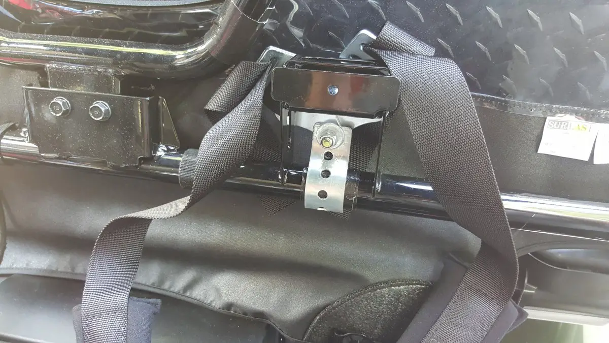

Will likely have to get 10mm longer bolts, but if you get the 4 point restraints made by BEARD with the automotive latch for a RZR800 they have mounting tabs on each of the 4 corners and you can put the top 2 together like this in the center with a piece of strap metal and the headrest bolt on each side as pictured above as I did on my P500.
20150818 163147 20150818 163156
20150818 163226 20150818 163618
Above is before I went full retard and mounted suspension seats in my P500 didn't change the restraint mounting at all.
