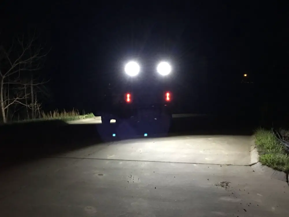

Can't help with 50" light bar, but rear cubes help a ton. Well worth it.
B
Boomboom907
Apr 27, 2016
596
620
Washington
Those look really good. Mine suck. For backup lights they are fine, but those 36 watts could have been put to good use on a real light bar. 3 100w bars don't touch one 300 watt bar. I'm not sure why, but there it is.
50-52 inch bar is the only way to go.

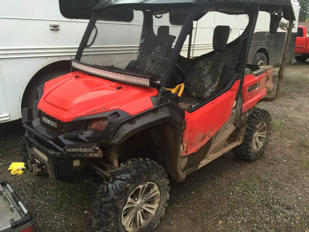

Image This is where we mounted it right off the ROPS mounts with brackets. There is no glare in the cabin the center lights on most are maximum 30 degrees on most works very well we can use or remove any window very solid and no weight up top or breakage.

View attachment 16457 This is where we mounted it right off the ROPS mounts with brackets. There is no glare in the cabin the center lights on most are maximum 30 degrees on most works very well we can use or remove any window very solid and no weight up top or breakage.
That is where i think i am narrowed down to install mine as well...
Can you provide some part listings and/or install details?

Absolutely marine. Did a post just a little bit ago this is the post I can provide more pics if necessary. Any questions just get back to me
